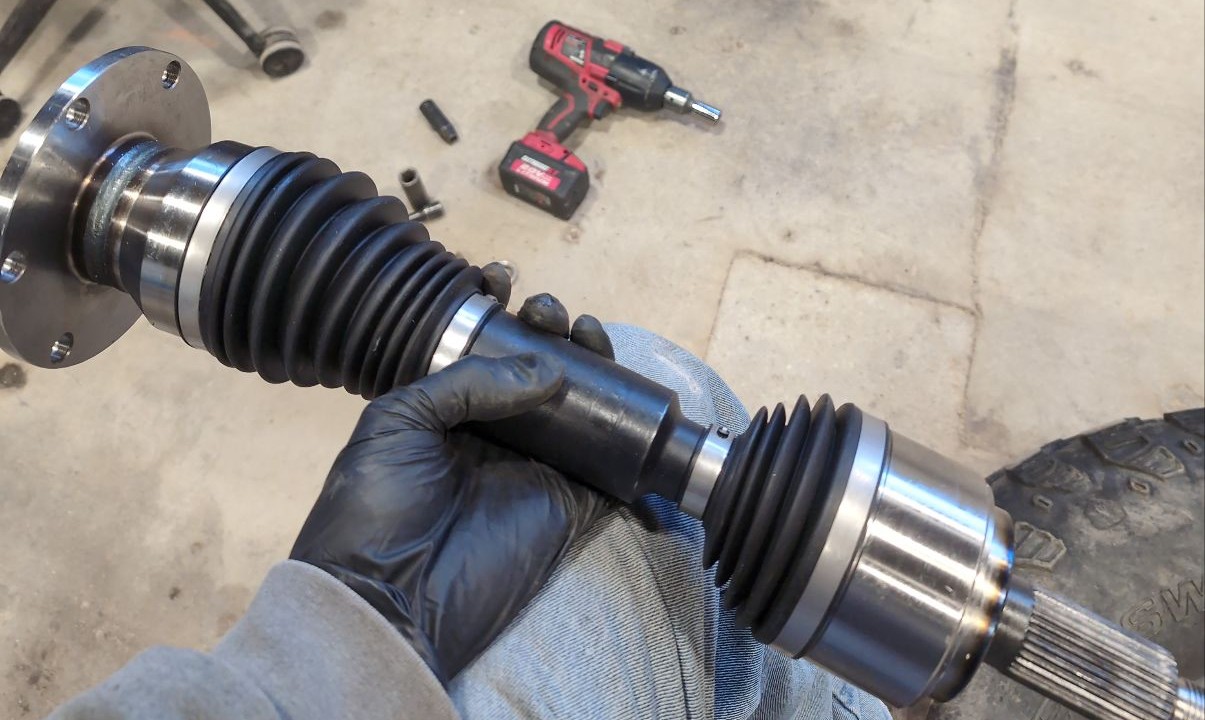

Well little delay as our HD driveshaft we did not grease the slip joint so it rusted solid totally our fault and was not able to be reinstalled when they put the dana 50 back in. We are officially back on the road and logging miles now.
atvspeed4
1,211
massachusetts
Well it was finally a success! No leaks and the new HD plunging CVs fit. At full lock and full compression with the bump stop slammed all the way into the cup the inner rubber boot barely touches the control arm but it won't cause any issues. Our old cvs with the tripod joint and larger boot rubbed often at just below ride height and we never had a boot fail in 8 years so we are not concerned with this ever so slight contact in extreme conditions.
We are waiting for a run of bushings and updated pricing from all of our vendors to finally list the first five for sale.

Hell yeah. Great news. Now to test them in Sand Hollow in a couple of weeks right? I am curious about the CV's and their performance, do you expect a significant strength increase over stock?

The only failures we have had over the years were the inner tripod style joint cracking the outer housing when fully extended. This removes the tripod and replaces with rzeppa joint like the outer cv and utilizes slip splines with ball bearings. Should be good improvement and they are cheap on rockauto now. The only downside is that with how tightly packaged everything is this is really the only CV shaft than can be run but for $144 each keep two spares if you want.
