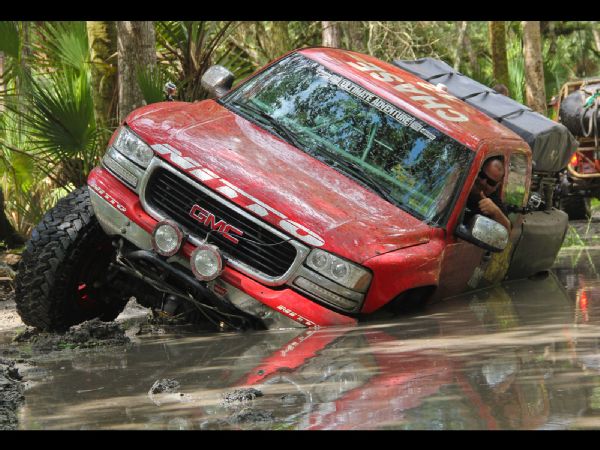

So the Technology Center was working overtime this weekend trying to get this project. We had to do little stretching, Building, bargaining, etc.
And here it is, not exactly what I envisioned in beginning but it works.
Specs: (I will update as they become more available)
2000 GMC Z71
SAS swap
Ram assist
Full race interior roll cage
3 person race bench with 4point harnesses
Lawrence GPS unit
Motor/shock tower cross member
32gal fuel cell
40x13.5x17 tires
17" bead locks
Np203/205 transfer case
2 persons ARB touring roof tent (not released to the public yet)
15k warn front winch on custom bracket welded to the frame
Counter lever 3pl adjustable reat shocks
King coil overs with remote res front shocks.
Upgrades by me:
Exterior:
JBA headers(CA legal) and complete custom SS exhaust with Magnaflow muffler.
