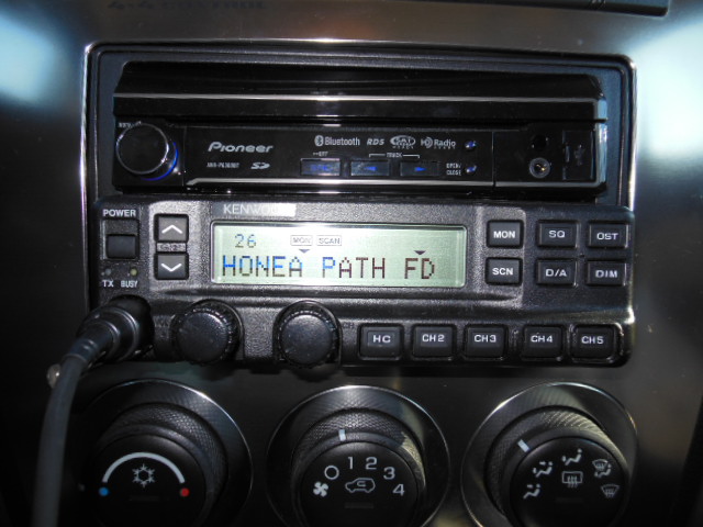

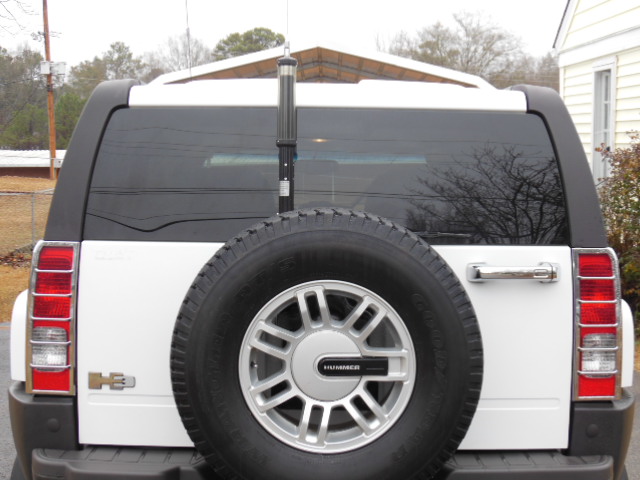

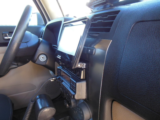

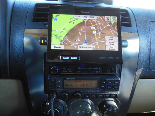

My main radio is a dual band Kenwood set up of a TK-890 for UHF and a TK-790 for VHF. Both are controlled by a single control head mounted in the lower Din Hole where the original AM-FM Rdio was. The TK series of Radios are built like a tank and are narrow and wide ban capable. These cover my Public Service needs such as Fire, EMS and Police monitoring. This also covers my two meter, 440 and GMRS needs. These can be found on Ebay and are very easy to program. In the upper Din I have a Pioneer Radio with the Navigation option. This makes very good use of the avaliable space. When I eventually sell the H3, all can be removed and the original radio reinstalled without any tale tell marks.
I'll do another post with my HF set up.

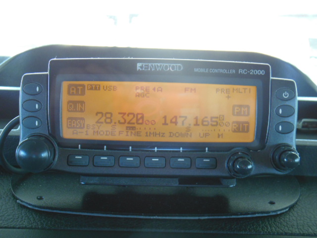

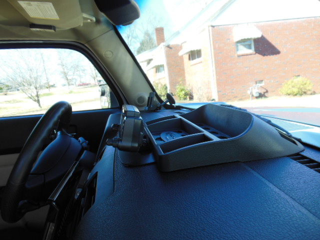

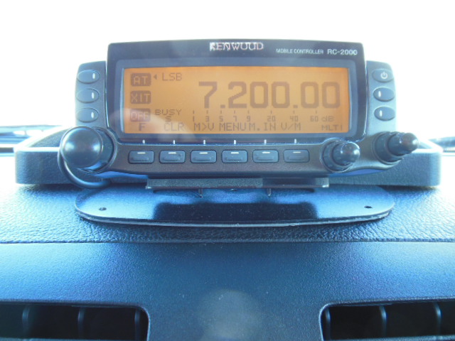

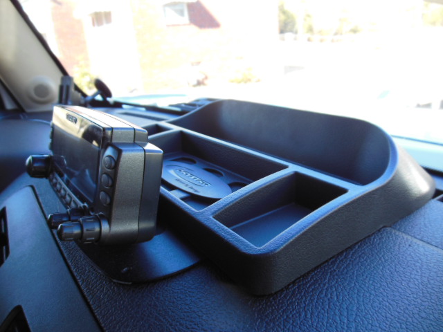

Here are some pictures of my HF set up. It is a Kenwood TS-B2000 with the RC-2000 remote head. The radio is mounted in the back and the Head is mounted on the dash with double sided tape and also slid under the Daystar dash organizer. There is a hole in the dash where a plug is removed to install the Day Star unit. The wire for the remote passes through this hole with no alterations. Again a very ergonomic mount with no alterations to the H3. This Radio covers HF from 10 - 160 meters, 6 meters, VHF and UHF. My antenna for HF is the Little Tar Heel II "screw driver antenna. It will cover the 6 - 40 meters very well. The antenna is connected to the radio and will automatically tune to the lowest SWR when the frequency is selected. As you can see, the antenna is mounted to the spare tire mount with no holes in the body. Works great.
