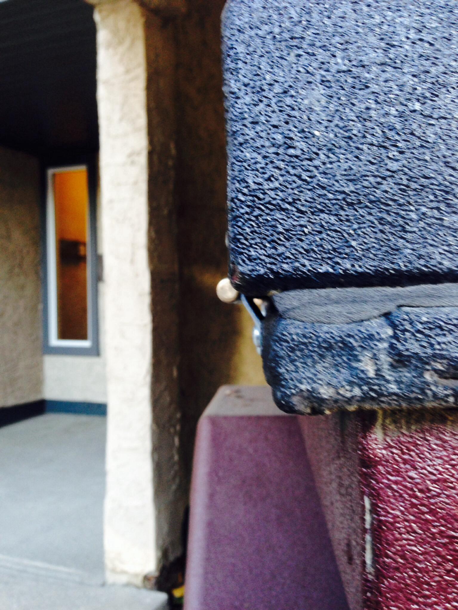

As you can see in the first pic attached the PO installed a bunch of different latched on the one side of the tub/lid.... The problems with this setup are
1- they are made of steel and are already rusting
2- they have a removable pin that can be taken out in a matter of seconds if someone really wanted to get in
3- they are far too small for the job at hand
4- they were installed with a mix match of hardware and that just drives me nuts!
The second image shows that he didn't even bother to line up the lid and tub when installing the hardware

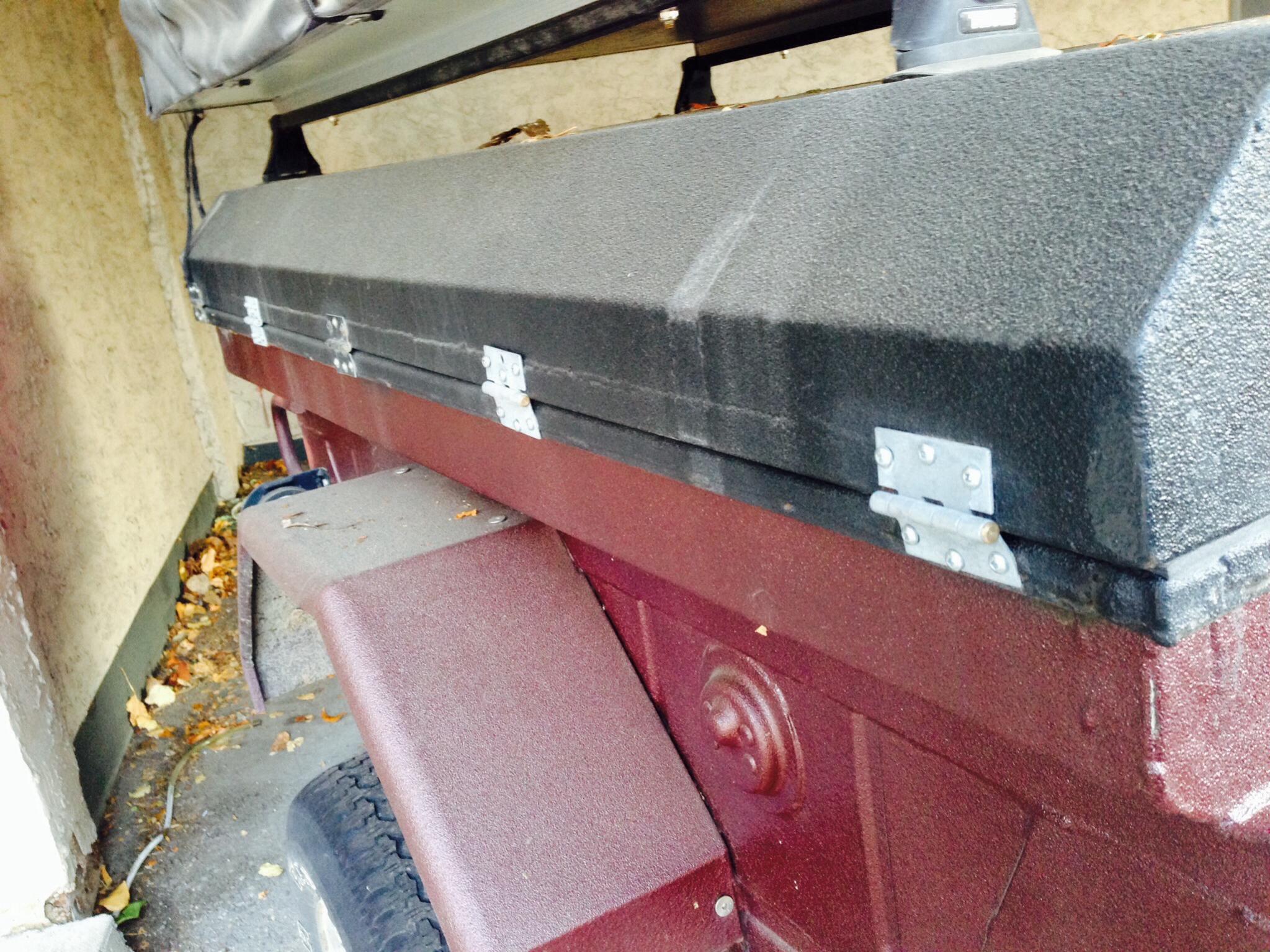

The third image isa comparison between the hinge taken off and the one it will be replaced with (fixed pin, stainless and about twice as thick)

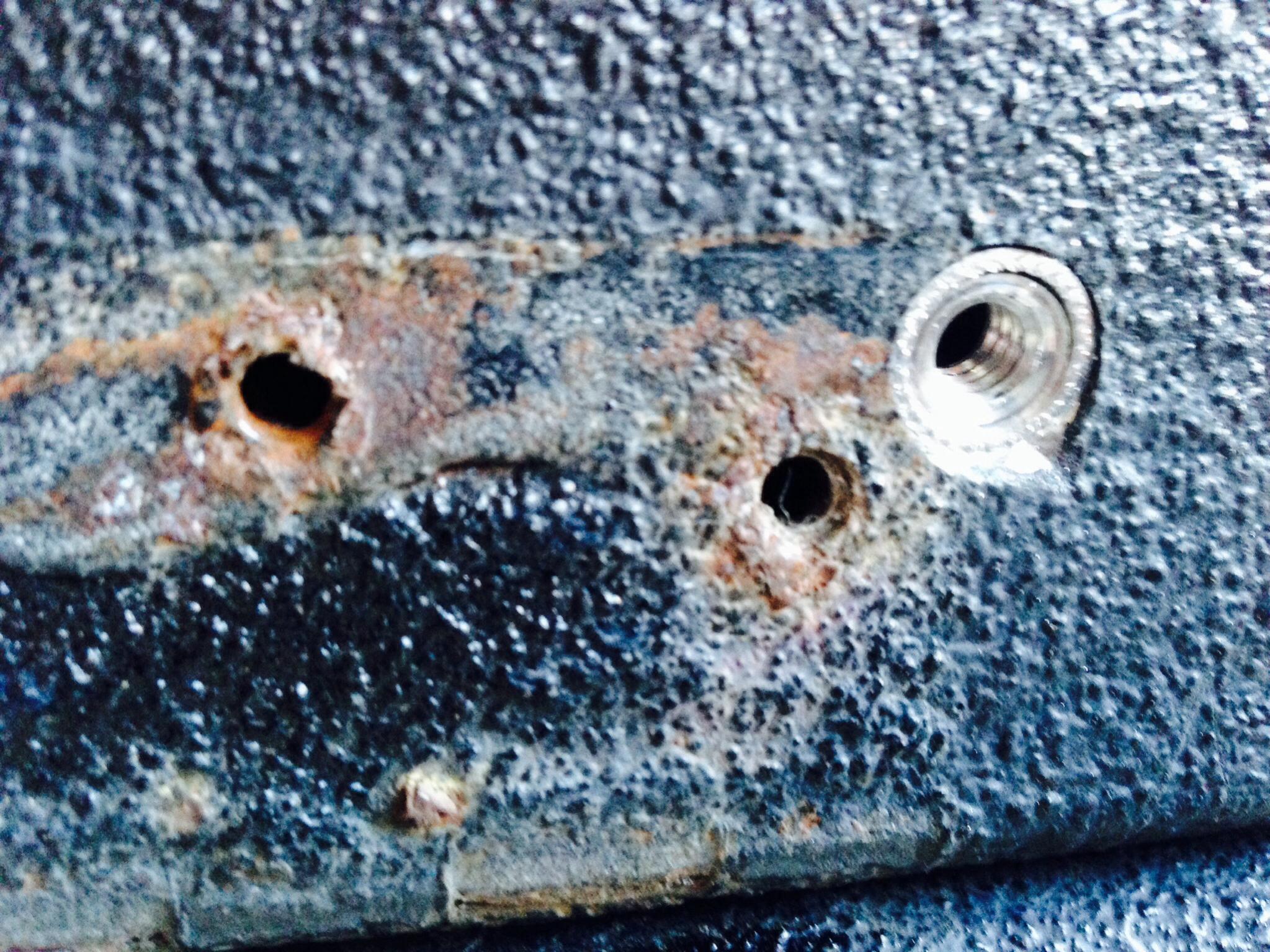

I decided that I would use Nut-Serts to mount the new hardware, figured it would gives clear look and make the install easier.... Plus I just wanted to try these thing out! (Shown in the 4th pic, next to the holes I need to fill from the old hardware)
..... But then I found out that the bolts I picked up are 1/4" too long to work... So I moved on to the draw latches for the opposite side of the lid....

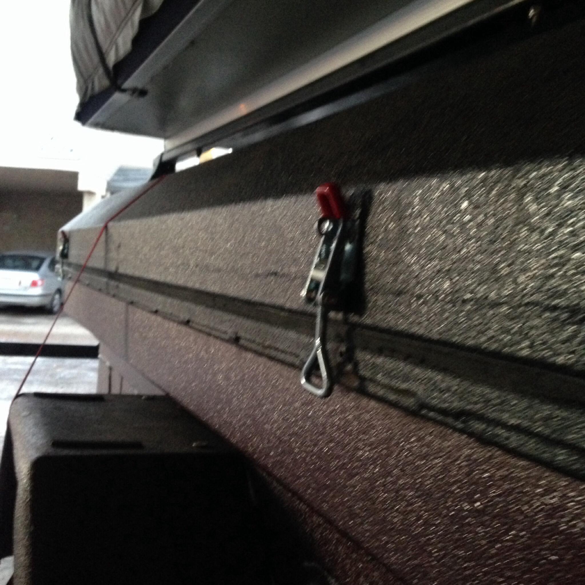

Ran into problems on that side too, but was working against the clock as the sun was setting so I called it a day after mounting the top half of the draw latch.
Again I used Nut-Serts to mount the latches, I also attached a pic of the tools used to fit them... All you have to do is slip the 1/2" nut over the bolt, thread the Nut-Sert all the way up the bolt, insert into the hole, turn the Allen key clockwise until it's tight, back off all the way and your done!

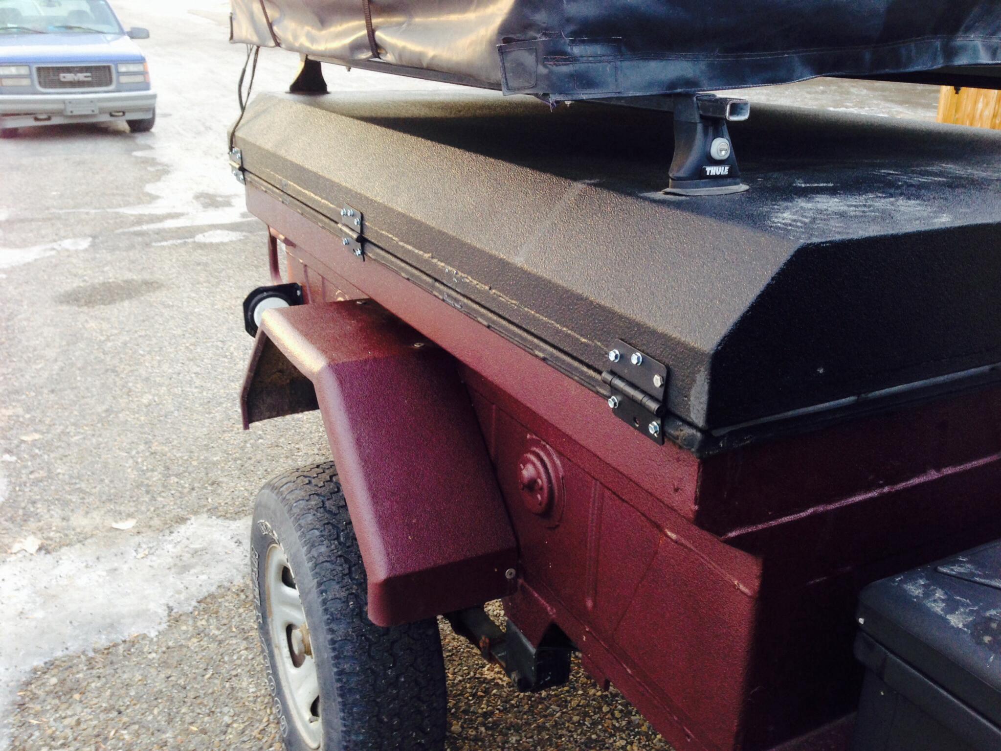

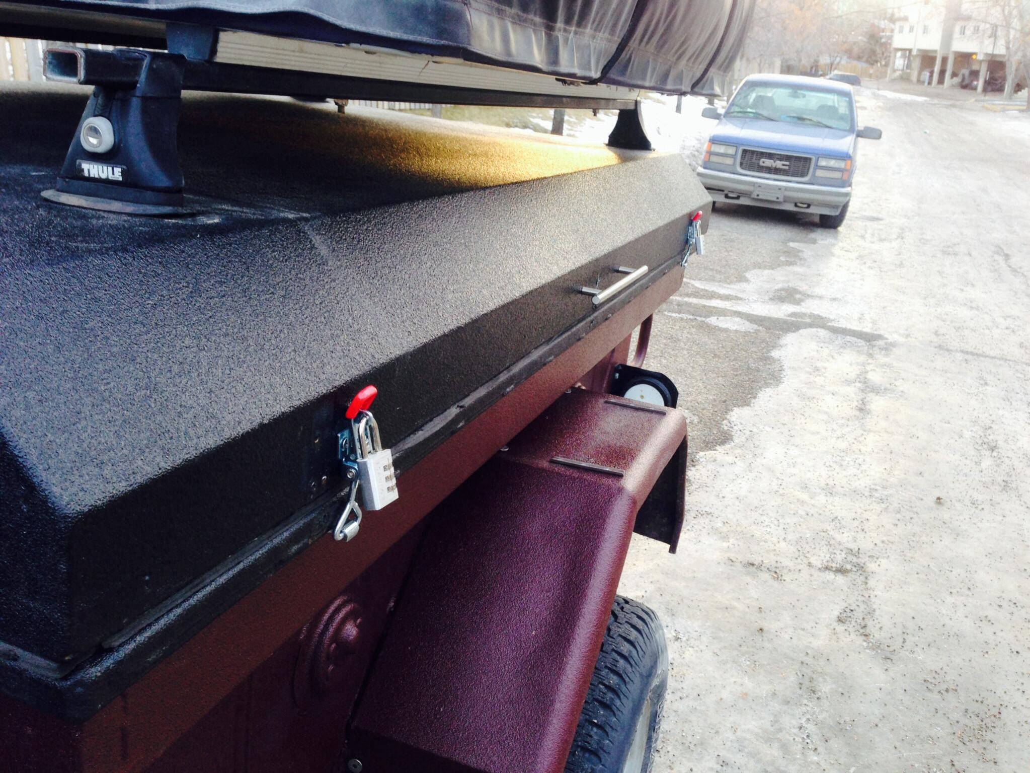

Got all the hardware installed over the weekend, not 100% happy with the hinge side of things and may rework it some more! but it's still 50 times better the the previous setup and am willing to put up with it for now.
Pic's attached!
