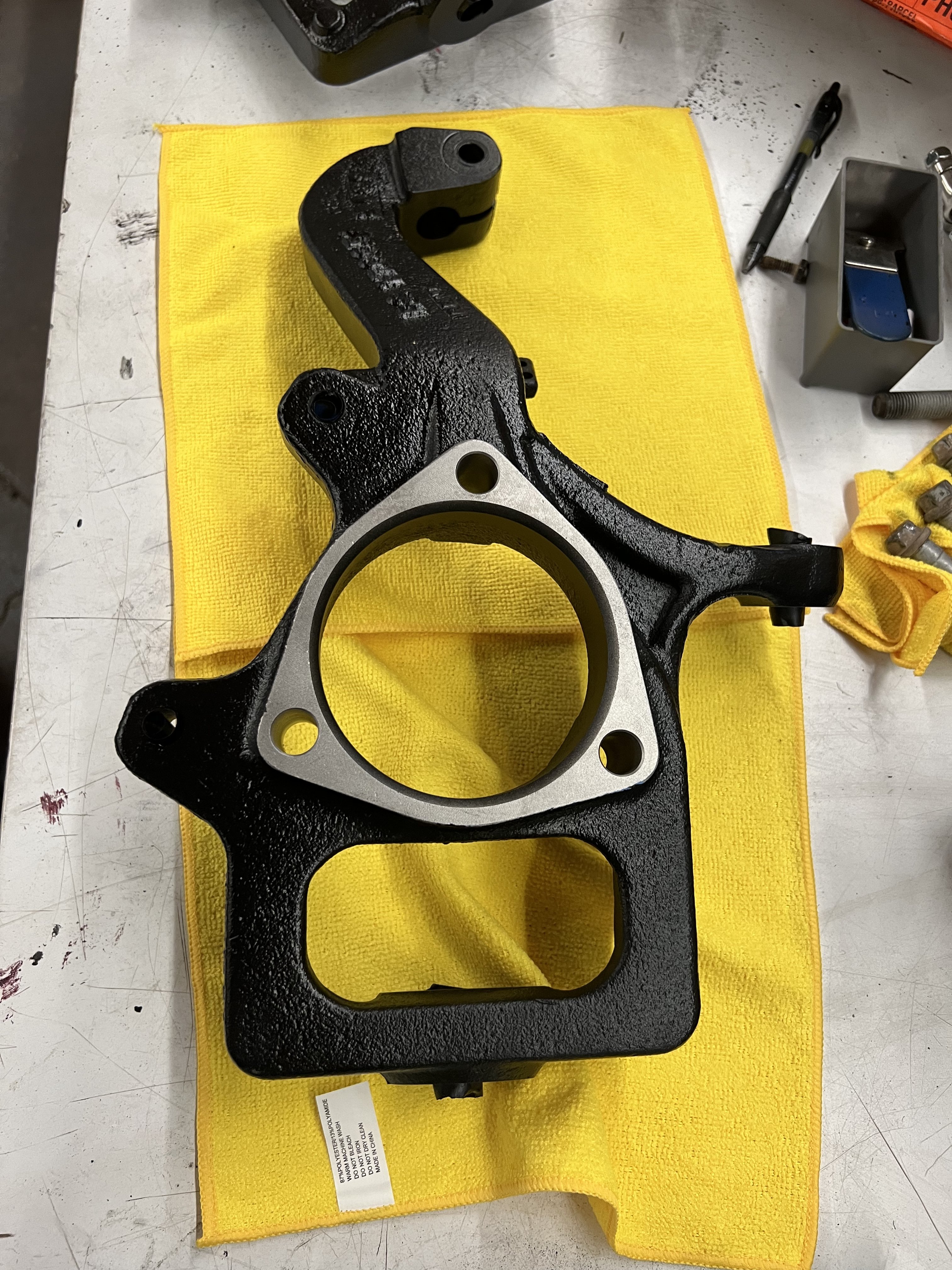

Rancho prep, getting all the redux parts done along with adding a layer of paint.

Front ends about wrapped up, waiting on some measurements so I can fabricate some bump stops, need to order shocks, etc.

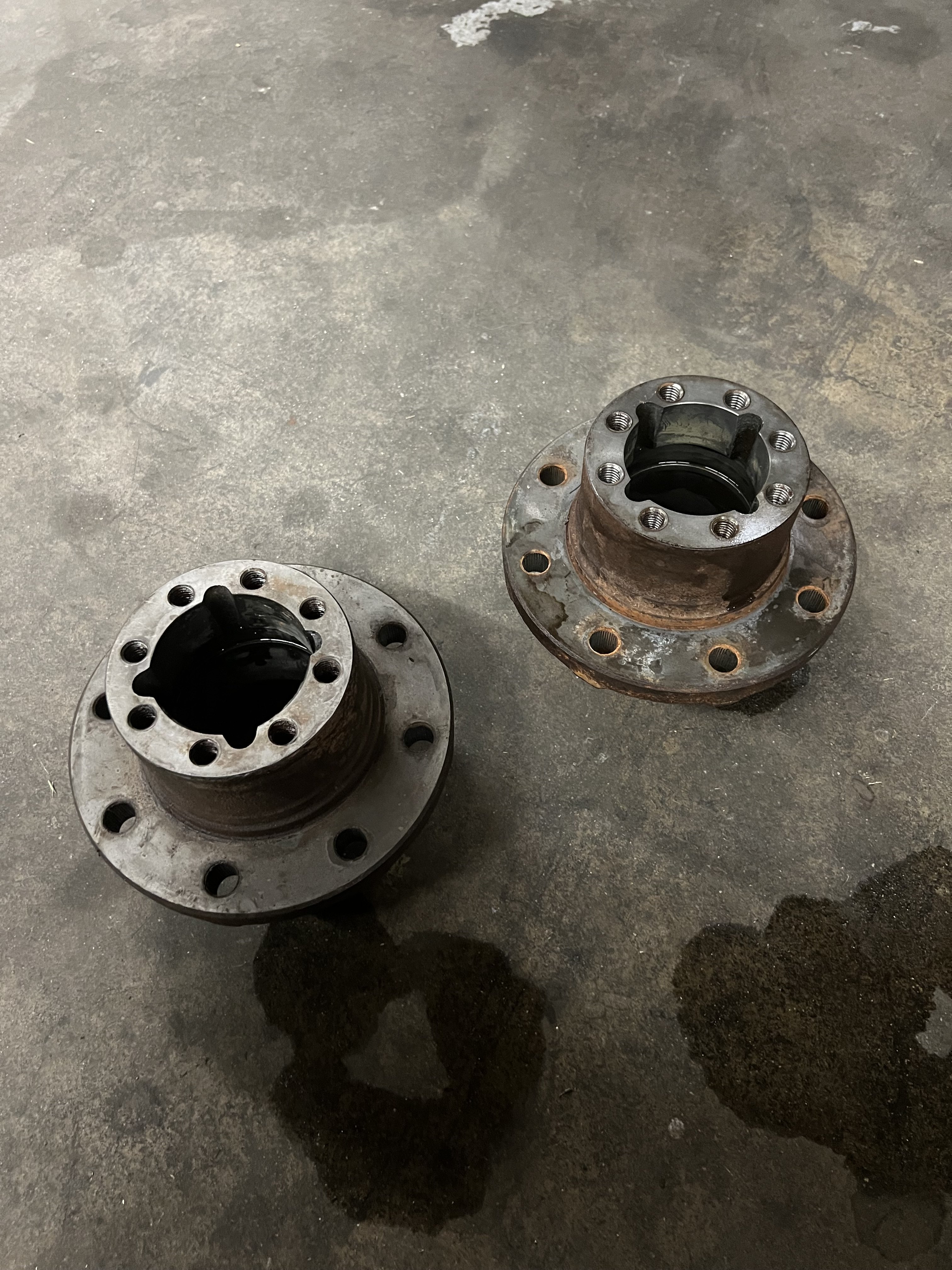

Cleaned up the hubs, sending them out to get sandblasted and machined for tone rings.

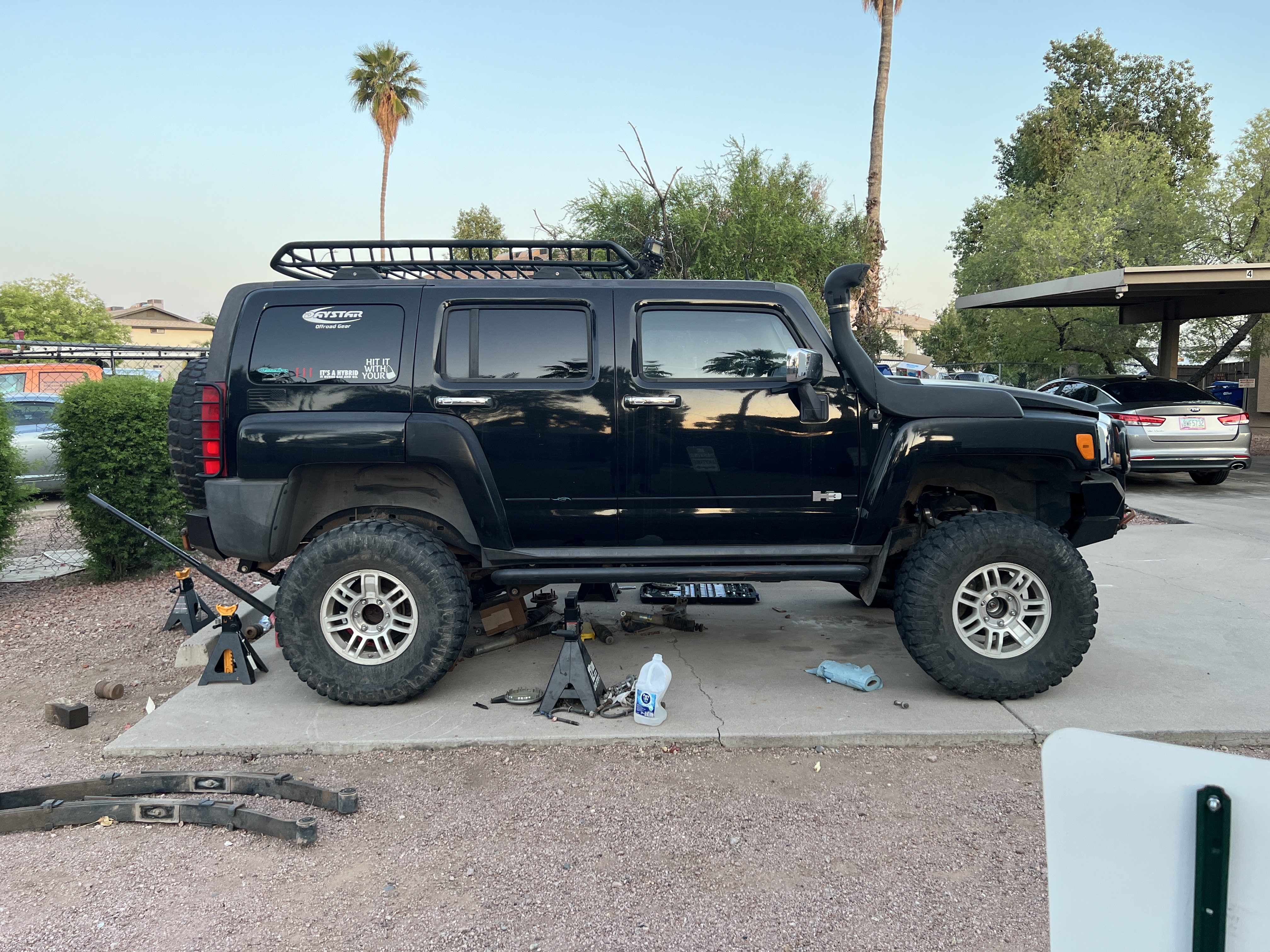

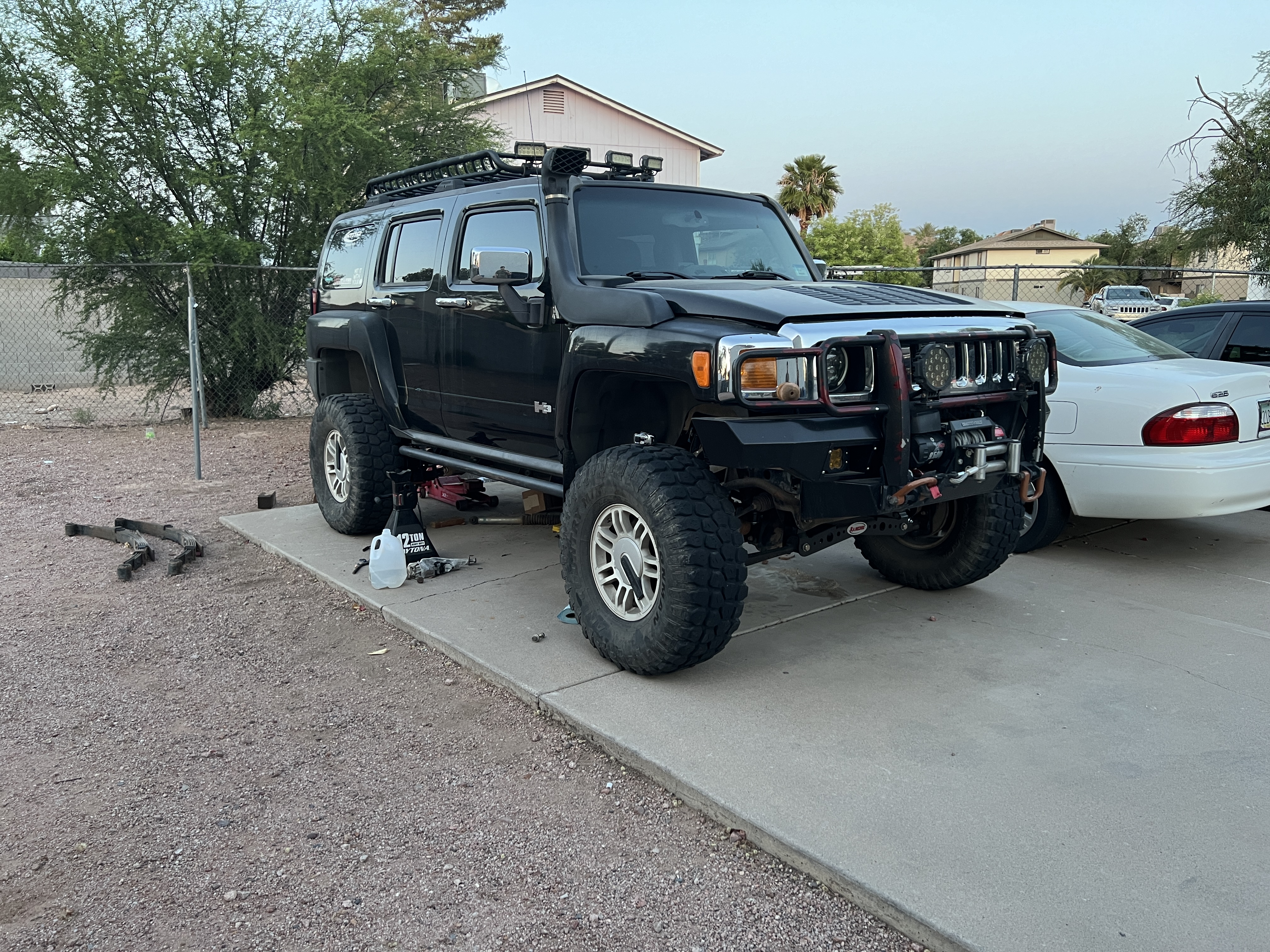

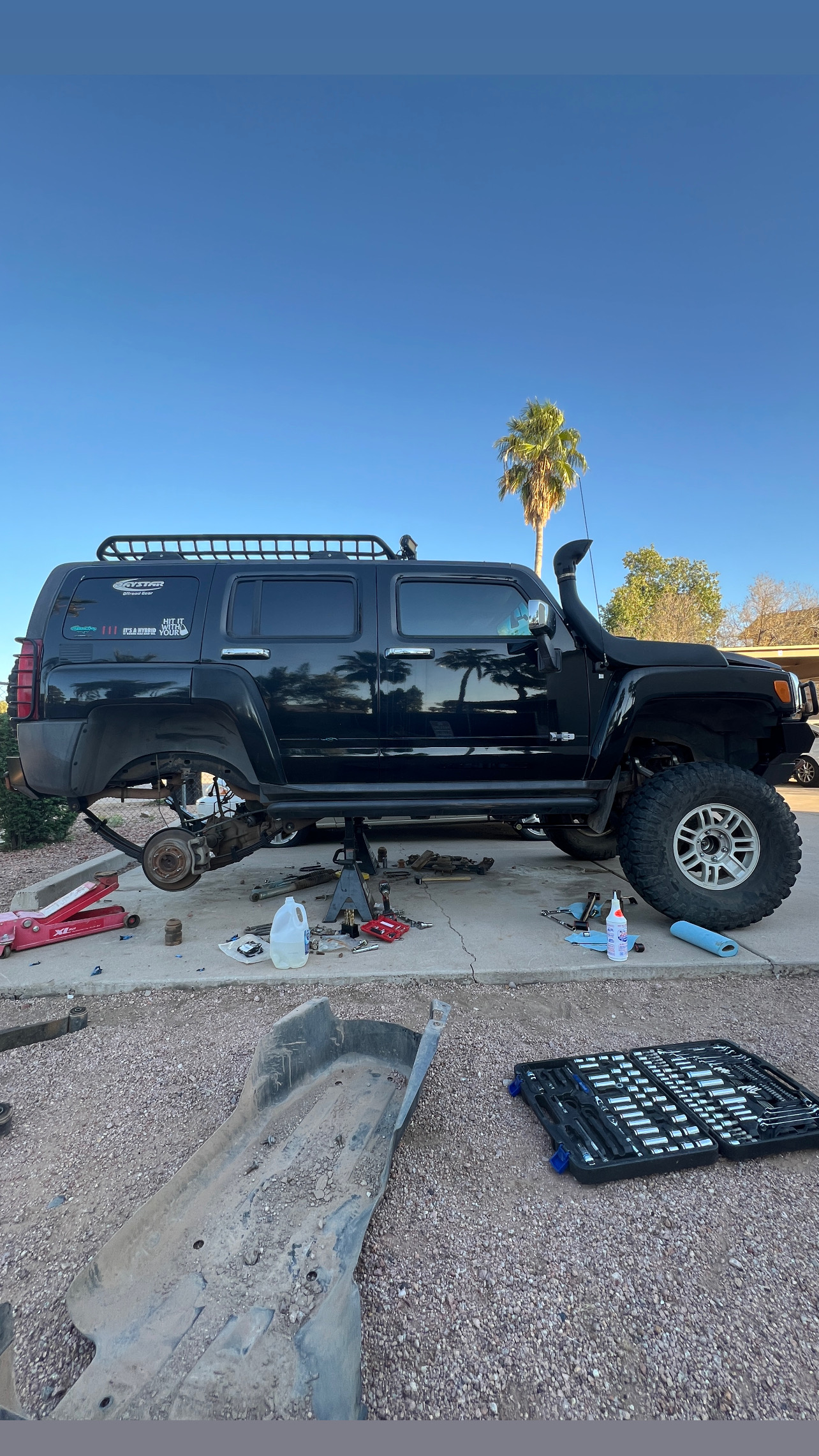

Lots of small fires getting put out, needed a weekend to work it and plan it out since January. 2 weeks out and it’ll be driving. Shocks won’t get here until the second week in May, which will be the last piece.

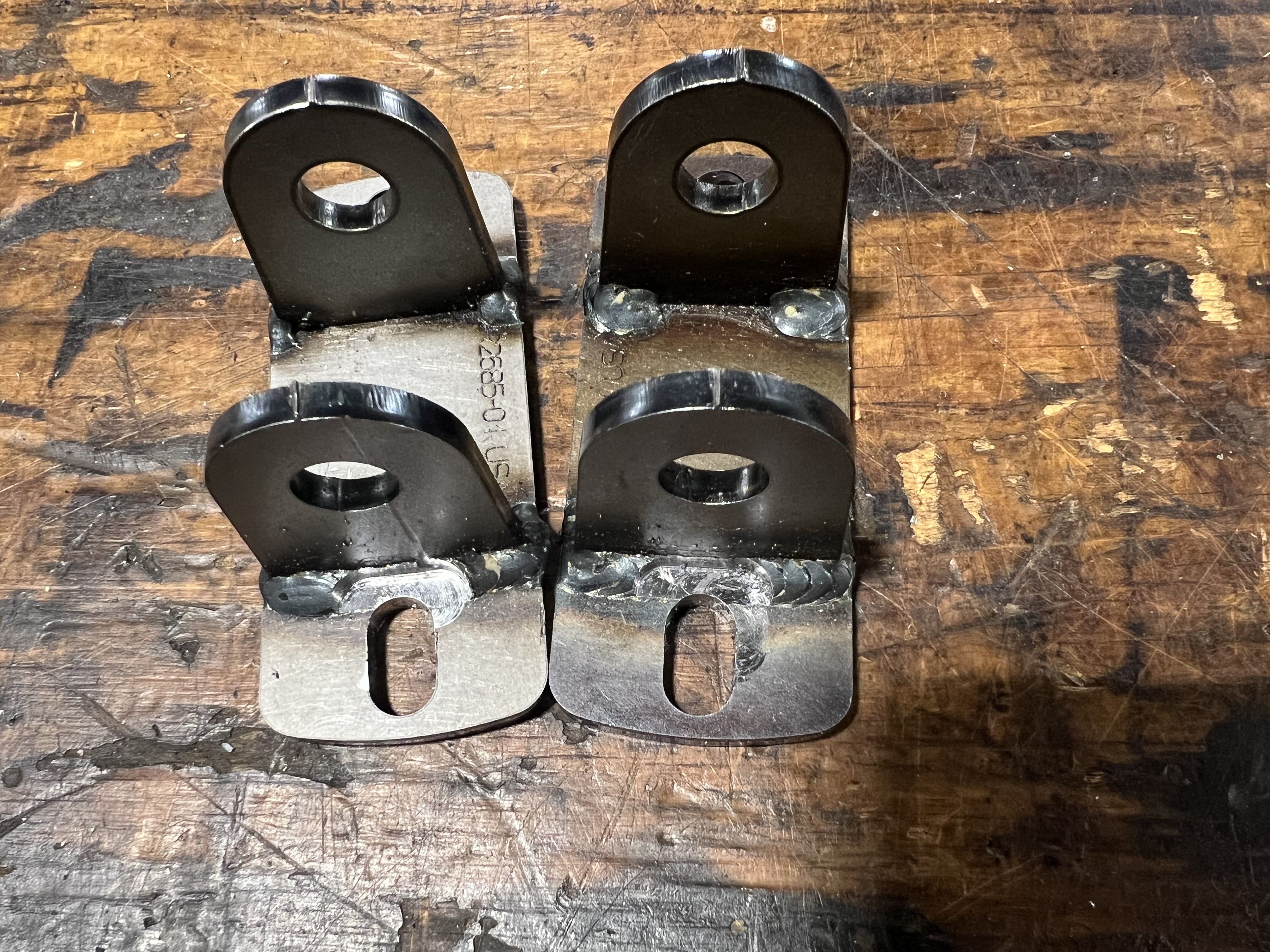

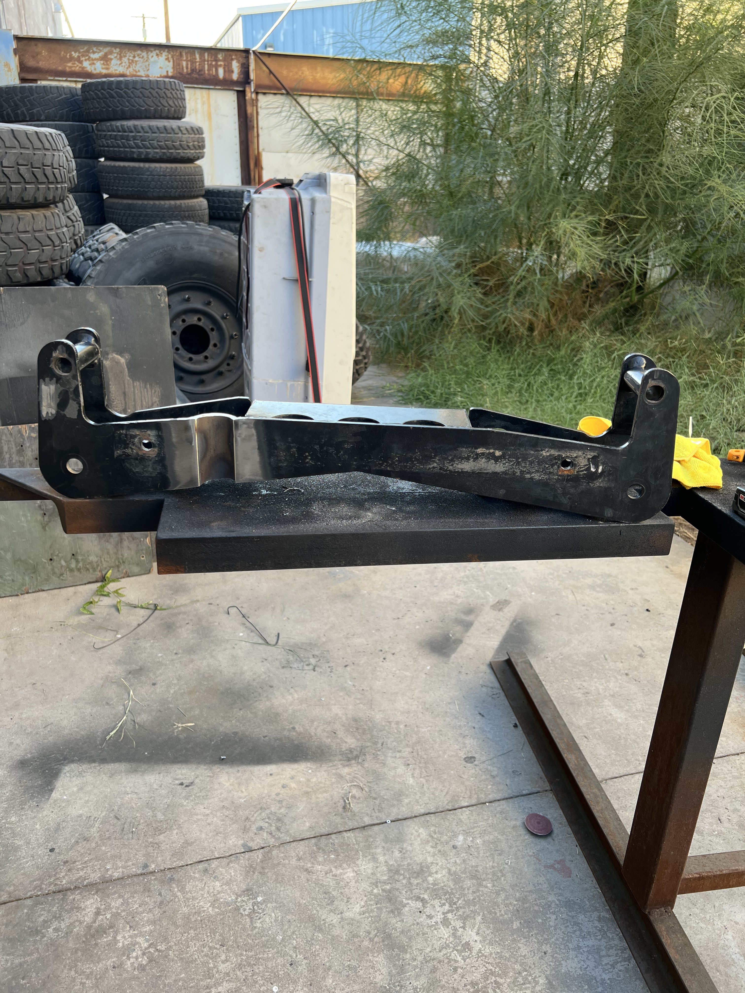

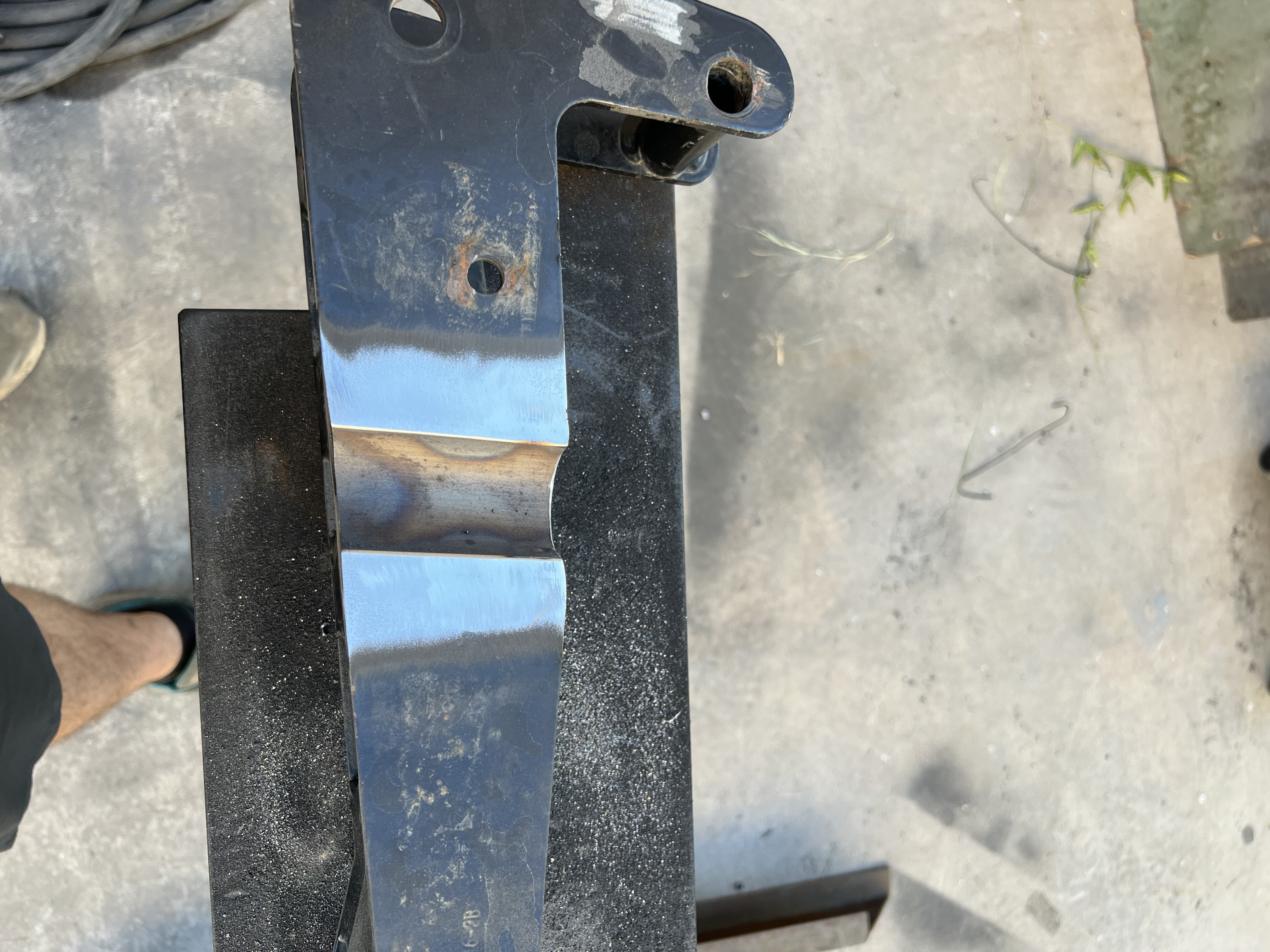

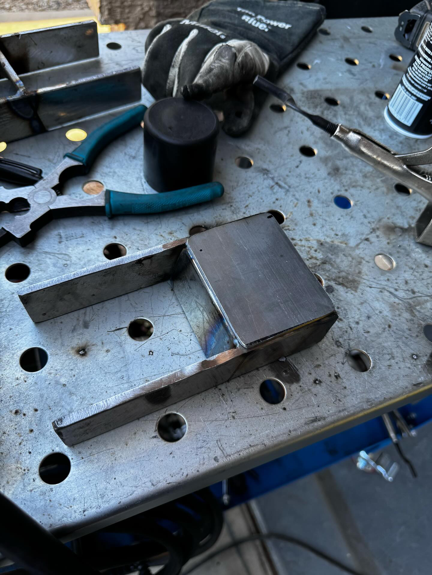

Xj bar pin eliminator machined out for the H3, going to run a bead on the other side to compensate for the amount of weld machined out.

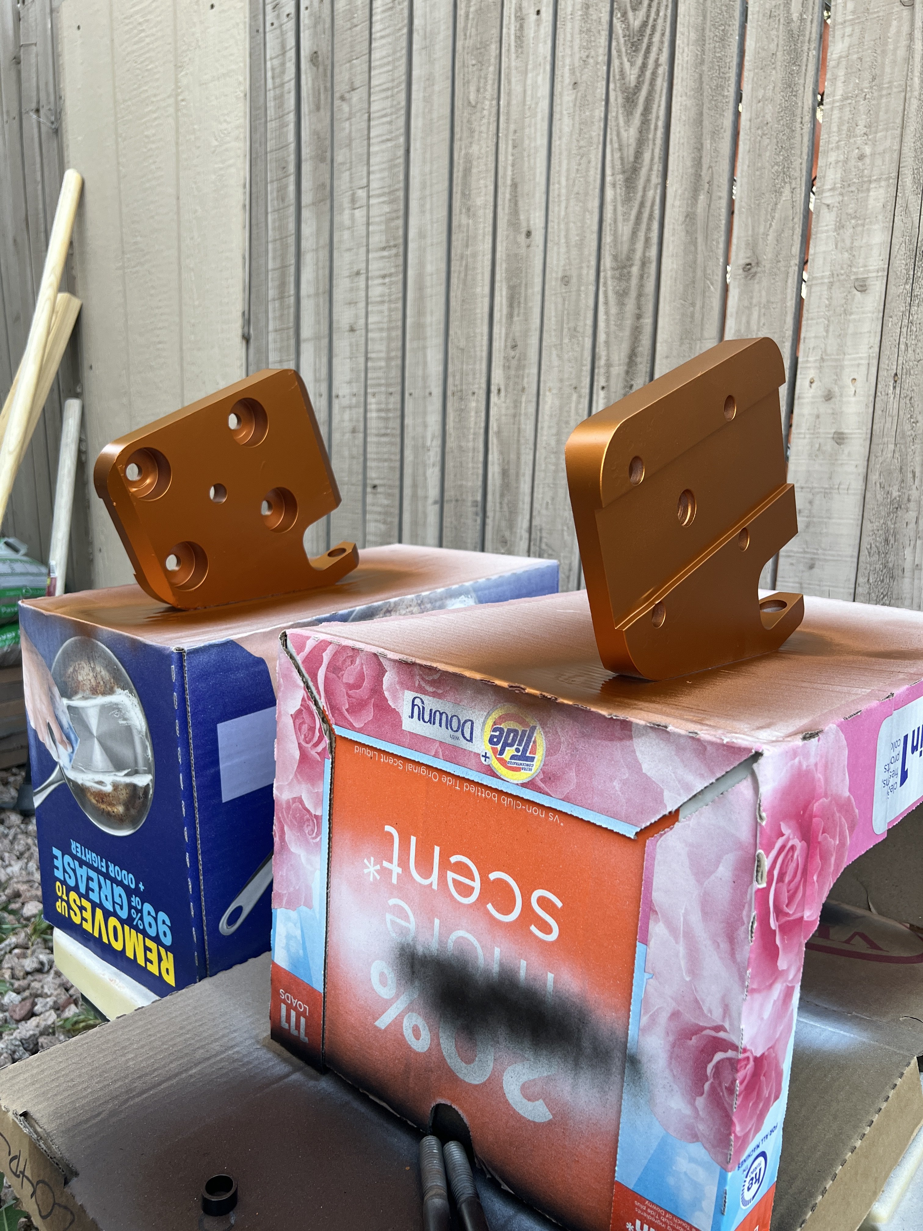

Better late than never to paint my tomp low profile mounts, slapped them on raw 4 years ago.
Buddy of mine helped save me some time with fabricating some bump stop mounts for me. We decided to box it in for strength.
