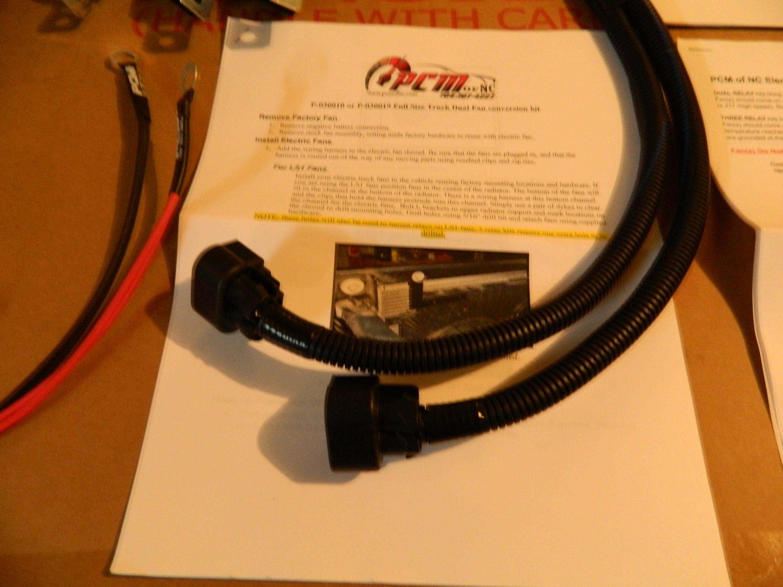

I started by taking inventory to make sure all the parts I ordered had arrived and that I was pleased with the quality as well.
Here are some pics;
The Dorman 620-654 Dual Electric Fan Assembly, I must say I am very pleased with it's heavy duty construction!
The Triple Relay Wiring Harness from PMC of NC, Very Impressed with the quality of workmanship! Like an OEM harness! Love It!

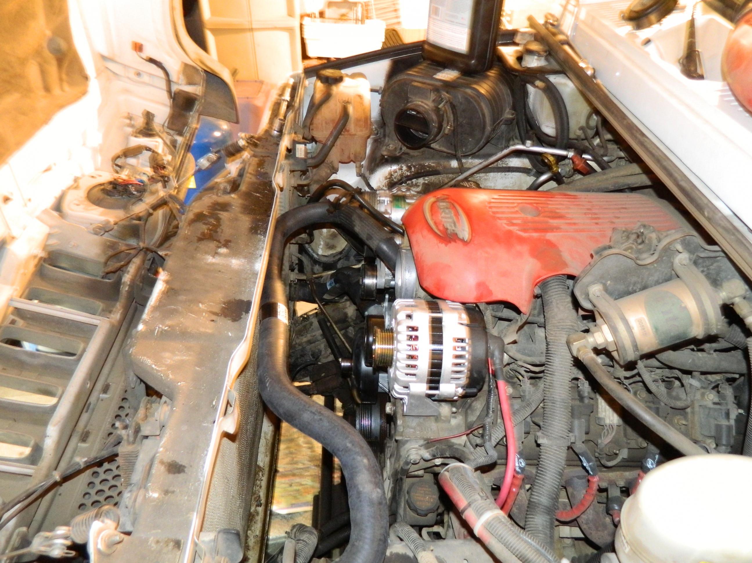

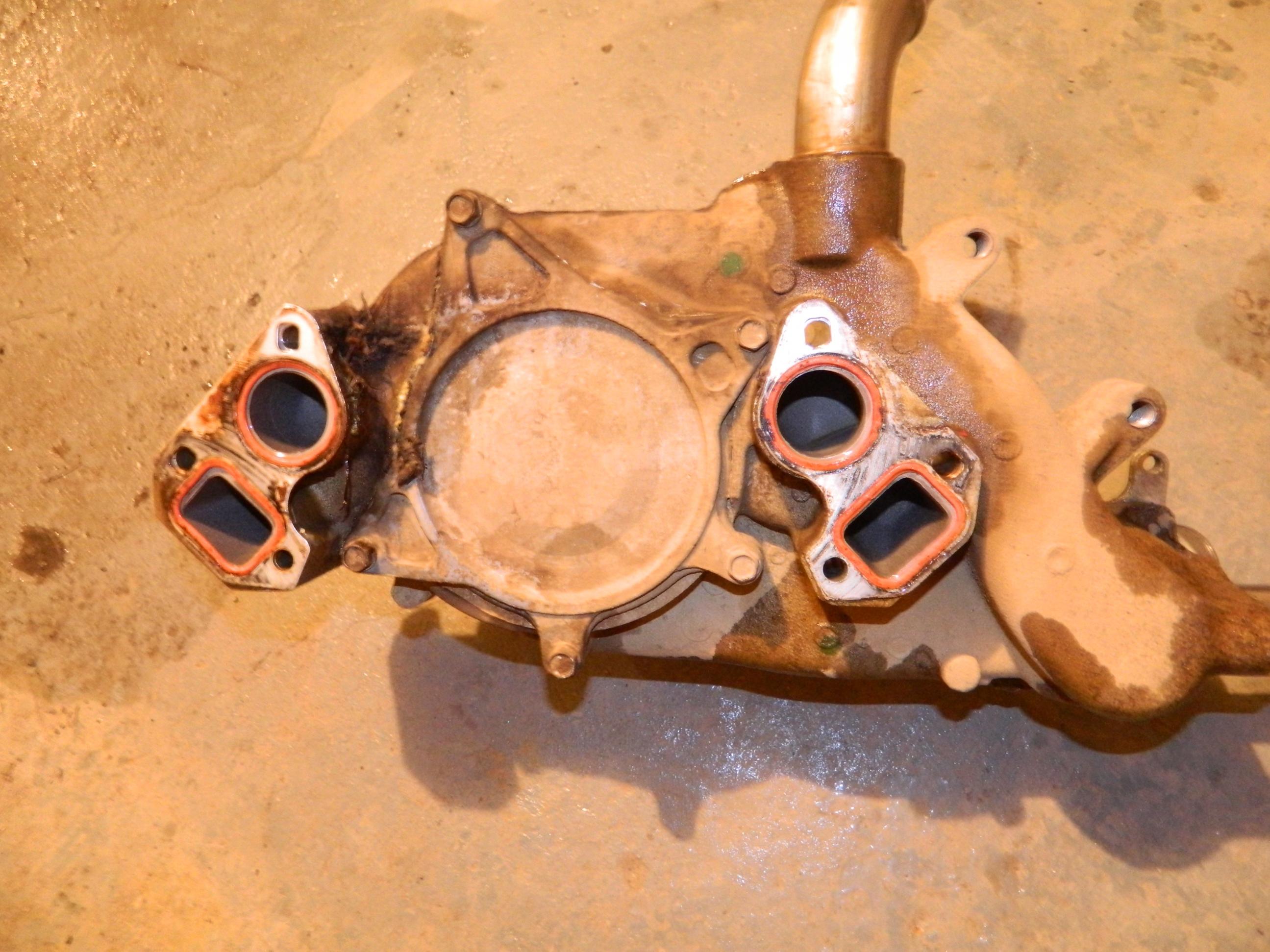

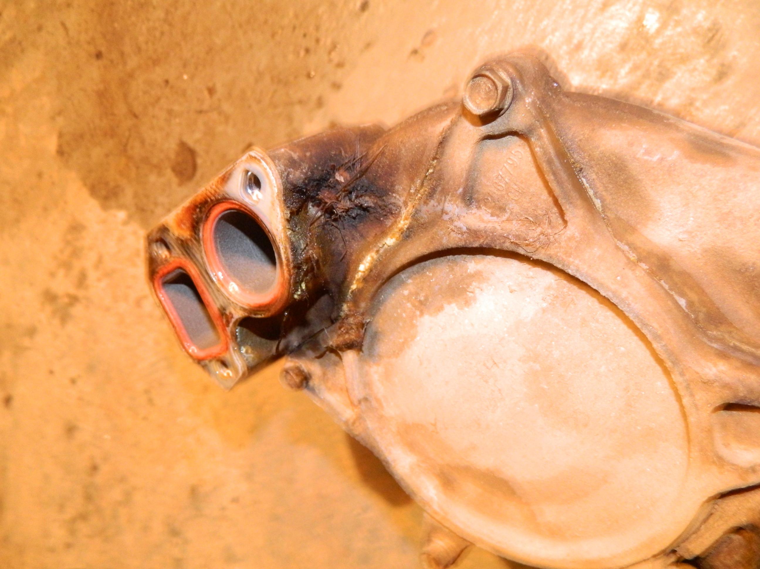

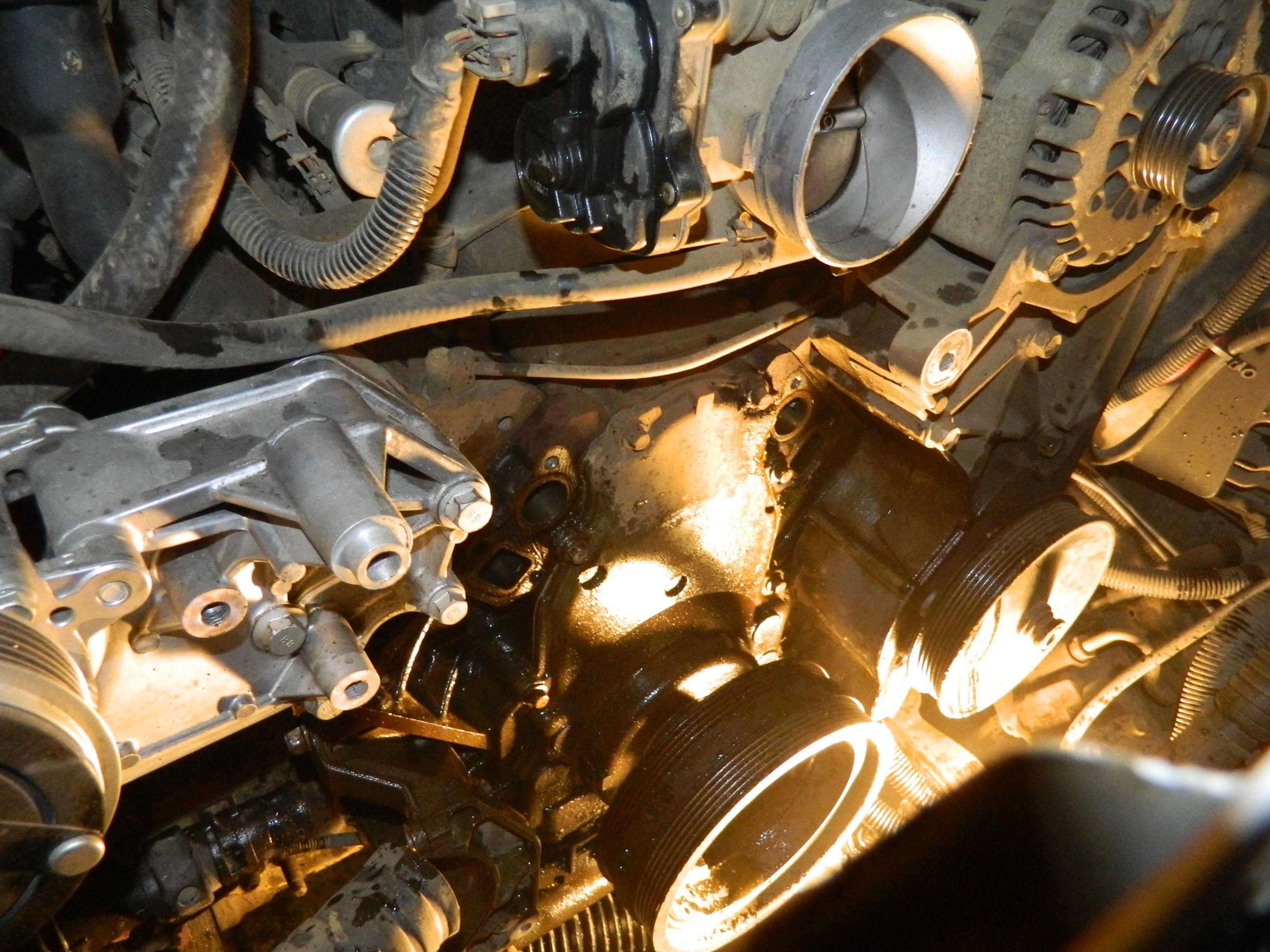

Next, off comes the water pump and obviously all the coolant;
You can see where the pump was leaking on the upper driver's side.
So I have also installed the new 253Amp Alternator but I need to upgrade the wire to a 4 gauge before I secure everything.
I have also blown out most of the lines for the cooling system and tomorrow night I will continue with the full cooling system flush before I install the new Evans Waterless coolant. I calibrated the refractometer this evening.
I also realized I need a new thermostat...for some reason I though it came with the pump...oh well!
I also noticed that my idler pulley is just starting to make some weird noises so I will be changing that as well since I have everything off!
The new E-Fan Shroud will require some minor mounting hole modifications but nothing to complicated!

So the new water pump is installed. I torqued the pump bolts in a criss-cross pattern in multiple passes. The first pass was at 15N-M and then the final pass was at 30N-M. I did probably 8 total passes until no bolt moved. I used thread sealer just to be sure there would be no leaks!
As well, before I installed the new water pump I retorqued all the front cover bolts...good thing to since I could do up to 1/2 a turn on most of them.
Before installin the new pump I completely flushed all the coolant line and passages with the Evans Prep Fluid to make sure that it would be water free! I even made my front tires completely flat and jacked the rear over 2 ft up to help drain the engine block completely!
So with all the new hoses and thermostat in place, I filled the system with new Evans WaterLess Coolant and did some tests before I installed the new Electric Fan.

Now to the fan install. I am noticing that I will need to reshape both the Engine oïl cooler lines and the transmission oïl cooler lines. Just too close to allow the Electric Fan assembly to fall into place! Oh well, it is not like I didn't expect some challenges.
On a side note the wiring harness that i received for PMC of NC http://www.pcmofnc.com/ Is Stellar!!! I am super impressed with the quality of workmanship and the sealed connectors. The included instructions are excellent...gonna make the final steps of the install very easy!
Here is what I got!

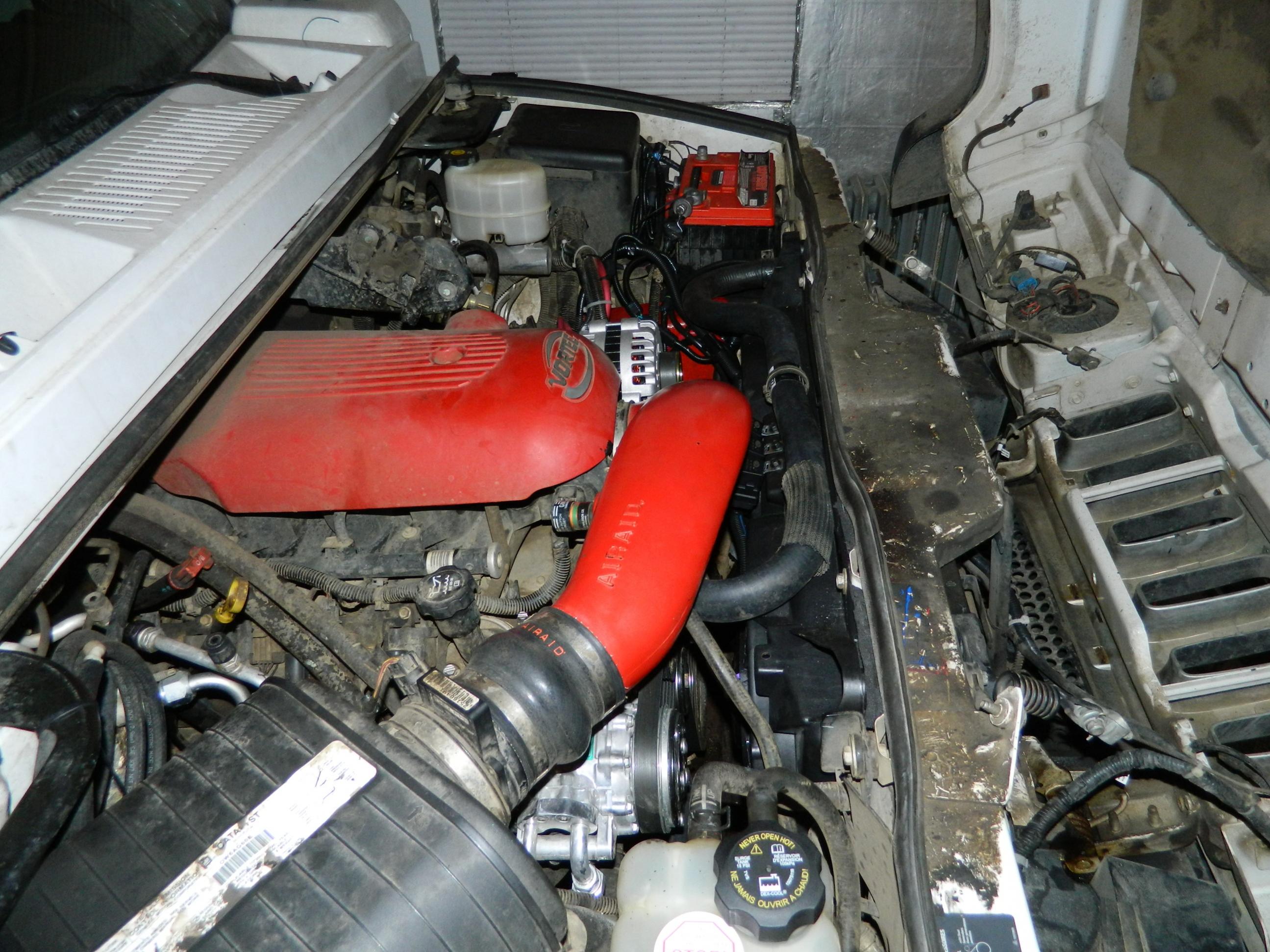

I finished it all off and IT IS AWESOME!!! I am Super Pleased! I still have to reflash my ECM at this to activate the fan control and do some final checks but overall done!!
So here are the final steps;
So I had to start by getting to the ECM. Can you see where it is hiding?
Yep, right Under that black cover!
Once the cover is off you can finally see it!
Once you release the spring clip retainer, you need to rotate the ECM to get access to the main connectors.

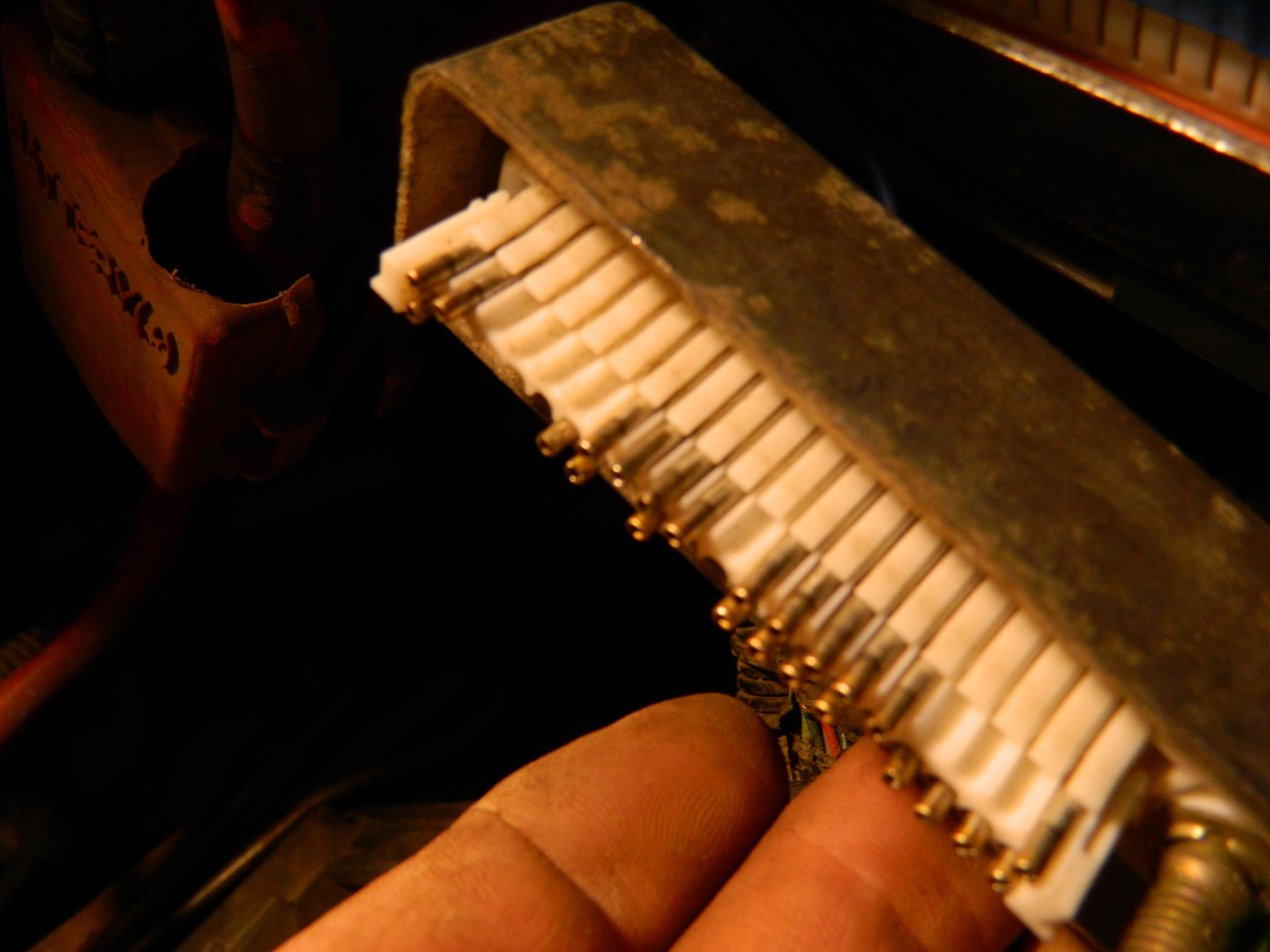

Once I pulled the connectors out I notice the start of some corrosion trying to get a start. The seal was slightly out of position, so I will clean the ECM and reseal it before reassembly.
Now to get to the ECM connections.
You need to put the Green wire in Terminal 42 of the BLUE Connector.
The connector is numbered so it is very easy to find and insert the terminal

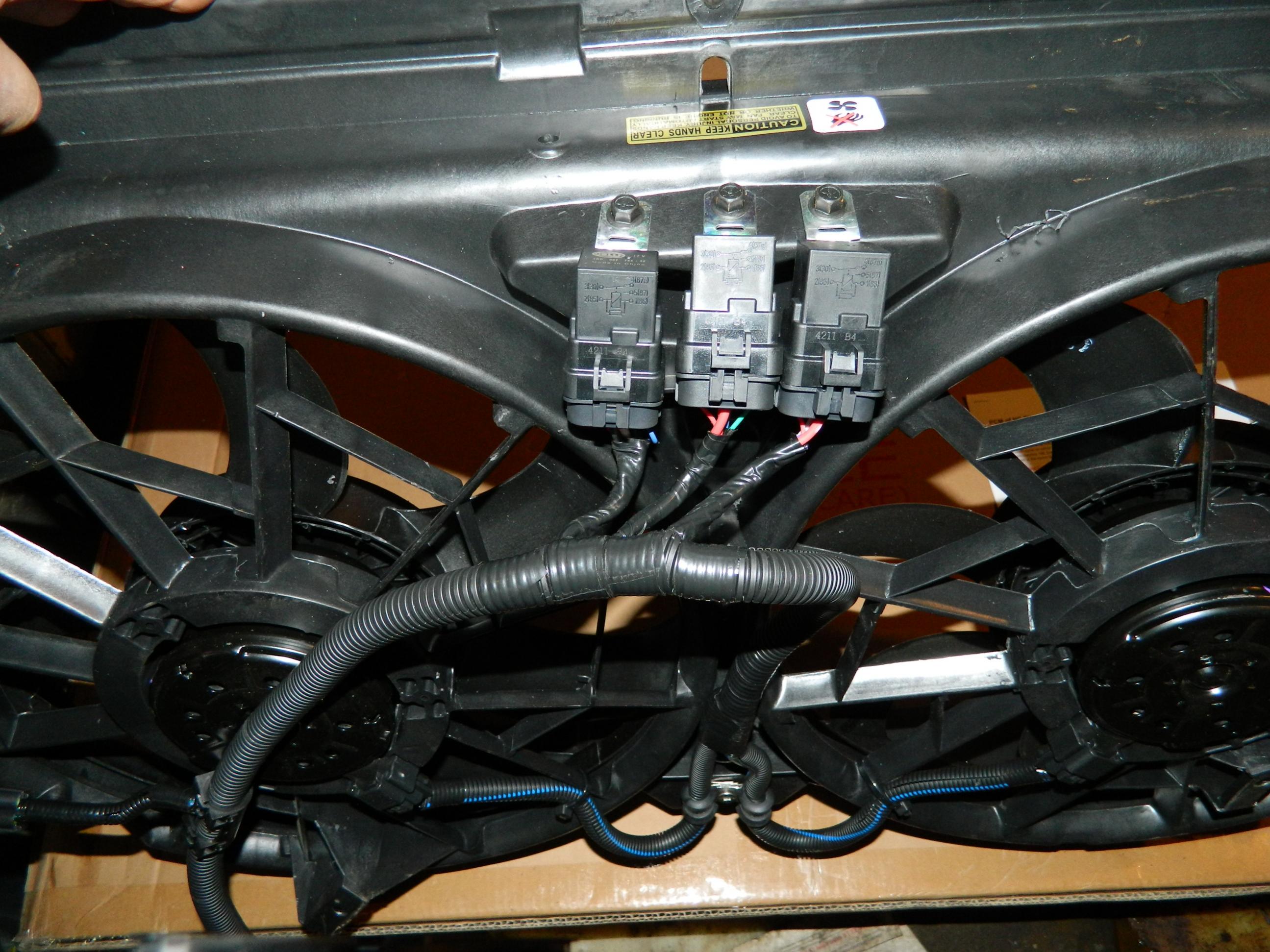

Now we get to the Dual Fan Assembly.
I decided to install some Rive-Nuts into the fan housing to allow me a secure place to mount the triple relays and to secure the fan connections.
I choose to mount the relays at the top center to keep them easily accessible and out of the majority of the water they might have to deal with!

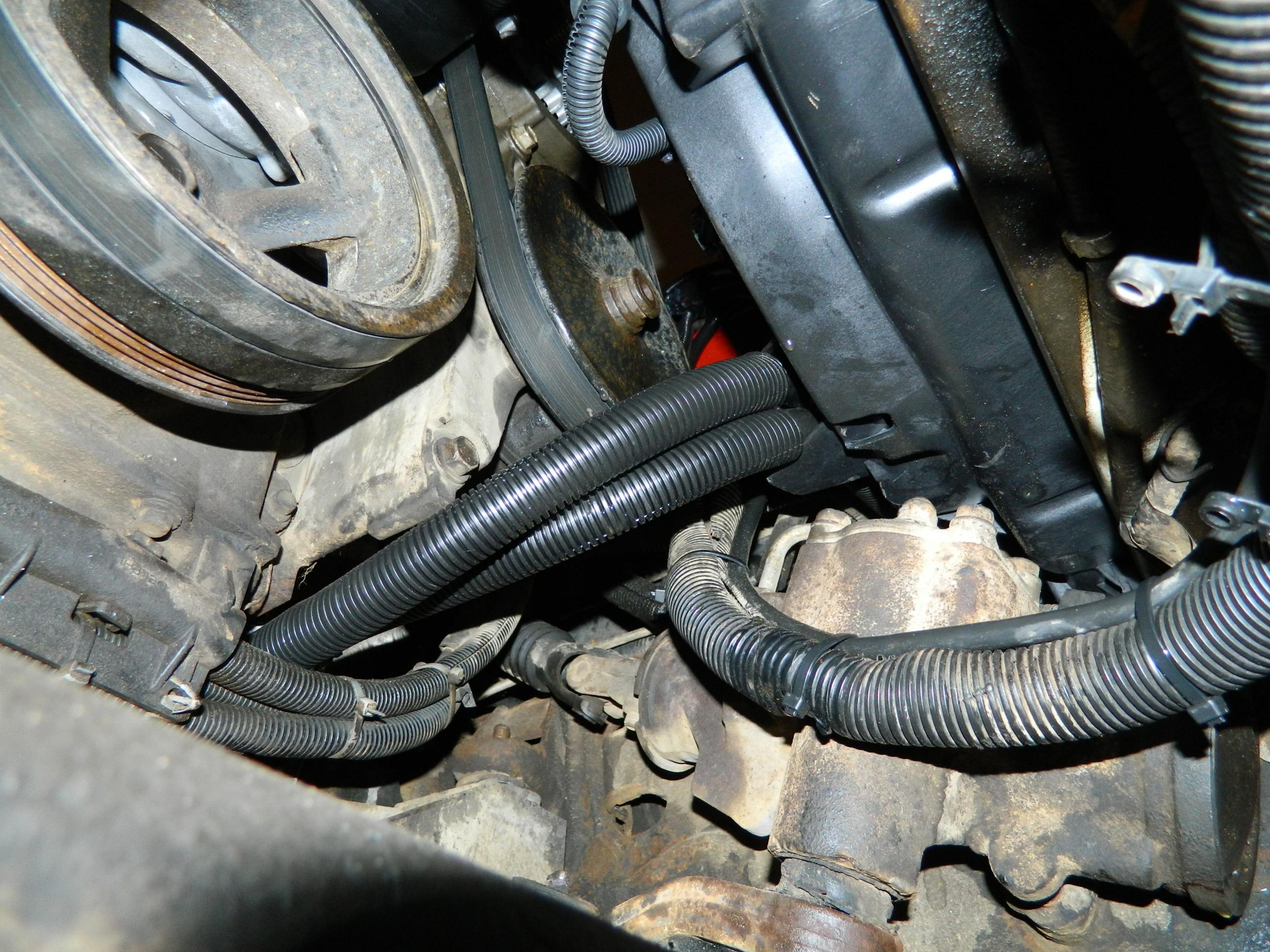

Now that the fan has been assembled with the harness. I did some test fits and found that I needed to add some foam tape to the upper edge to get a good seal to make sure all the air goes thru the fans.
I also had to trim the lower fan assembly lip by about 1/4" to avoid contact of the shroud to the radaitor fins.
Once that was done, I had to remove the engine oïl cooler lines to allow me enough space to drop the fan assembly easily into place.
I had to customize the oïl cooler lines and I think they turned out better than OEM! Plus they now clear the Dual Electric Fans! I will be making a separate build thread for the oil cooler lines.
The last step was to connect the fan wiring to power and ground and I temporarily connected the manual fan control switch that will be mounted in the upper map light panel above the rear view Mirror...but that will be next week!
I tested the fans and Man do they ever SUCK...Air that IS!!! I highly doubt that the OEM unit could pull that much air thru the rad!
