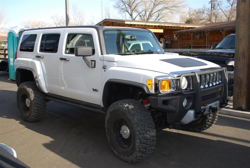

Believe it or not, that was my next option with the Predator winch system being to expensive (and I want to use a winch of my choice and not what comes with the kit). Currently this is the option I am looking at and like it best because I like the fact you only have the weight on the front end when you need it and the other 99% of the time it can be in the cargo area. You would also have the choice of mounting on the rear hitch for recovery also. There are no front hitch mounts on the market (that I know of) that don't affect the approach angle. The Curt Manufacturing one will be in the way all the time and kill approach angle but I have seen several nice custom units. If I go this route, I will replicate the one on the white H3 GM/Hummer had at MOAB in 2008 and fab a custom mount that mounts between the frame rails.
131_0810_06_zoctober_2008_4x4_truck_tech_questions_and_answers_nuts_boltswhite_hummer_h3.jpg
Something like that would work nice with a cradle mount like this and used it only when you need it but I would route/mount the Anderson Power quick connectors like they did on the above H3
