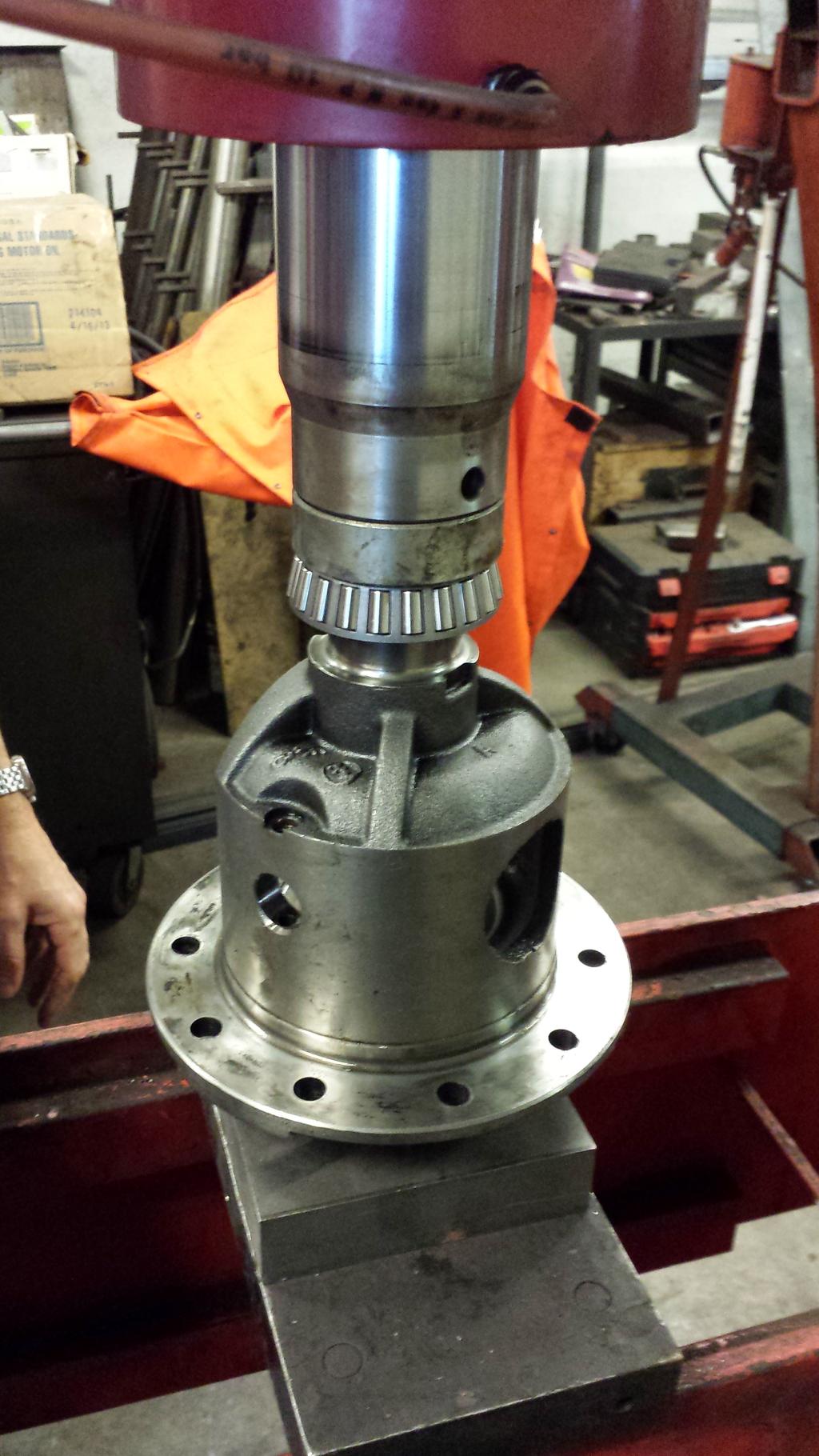

The H3 had a pinion bearing go bad in the front diff. My original plan was to pull the front diff and rebuild it with a new set of gears, bearings, etc.
Well opportunity came when a rig popped into CJ (4speeds) shop for an SAS. I took the 4.56 cast iron front with locker and the rear gears from her and put them in mine. With some help from CJ (well a whole lot of help) the rear was regeared to 4.56 and new (to me) front diff was put into place. Ran into some hiccups along the way....carrier bearings on the rear were bad, luckily the local parts store had some. Also threw in some new axle seals in the front diff for good measure.
We also put the rest of the outfitter designs bushing kit in, that axle is not moving anywhere any time soon.
I also have the rancho kit from the same truck that will be installed sometime later this year.

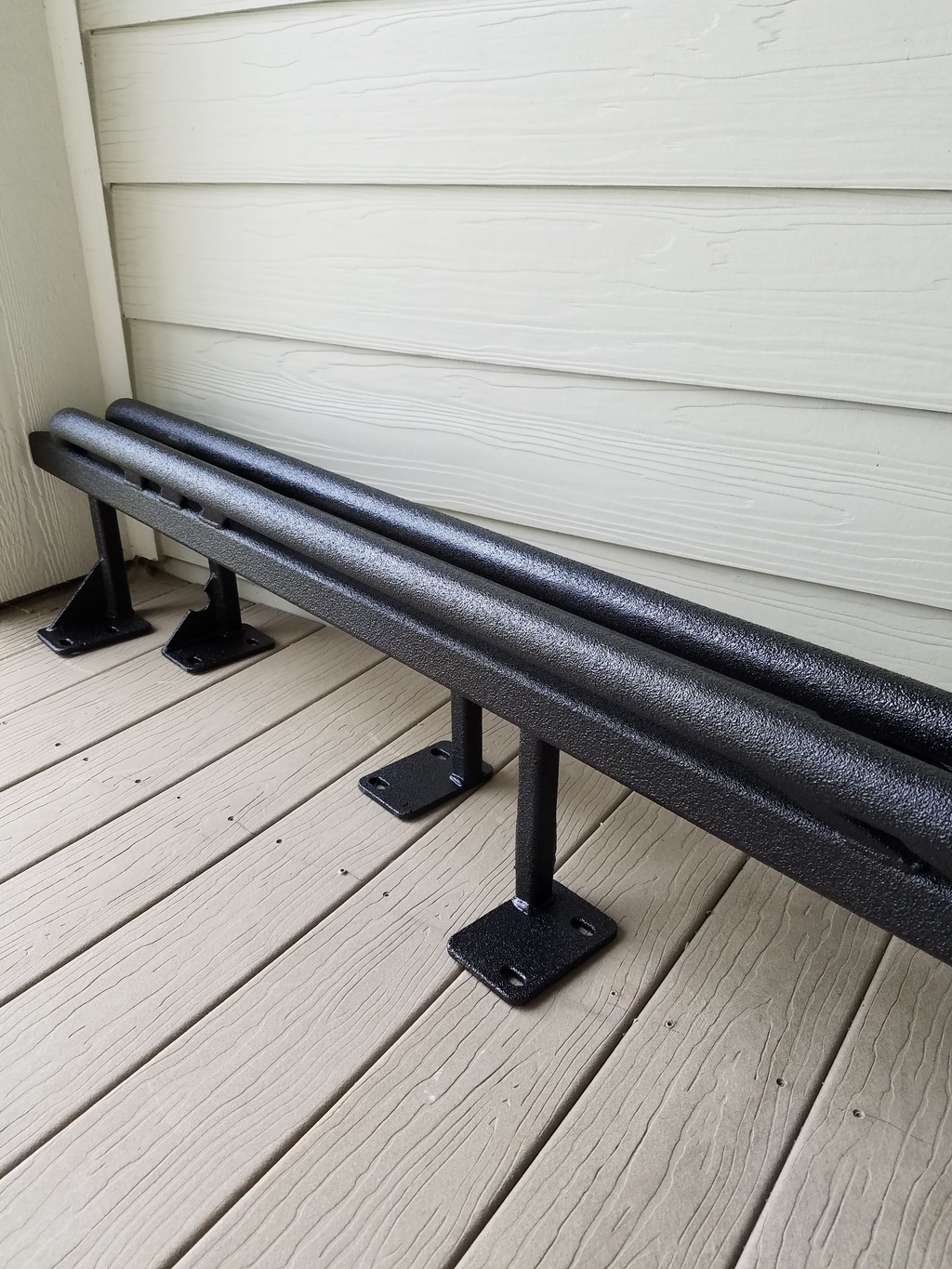

I had the BA bumper and rock rails blasted and coated in line-x platinum/premium, whichever one is their highest quality spray, to ensure it won't fade from UV rays.
I also threw on the engo 10k-s winch that has been sitting in my closet for 3 years. Installing this bumper by yourself is not the easiest thing to do, but doable.
