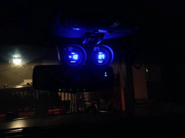

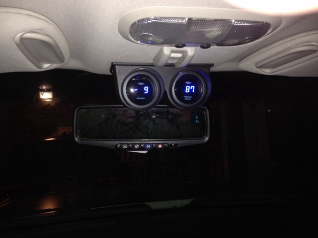

Lastly I installed a temperature sensor in my tranny before deciding to break for lunch.... Well pre-supper since it was 3pm by this point I hope to get this hooked up and running along with the boost gage before the end of the weekend
Worked into the late hours last night and got the rest of my boost and trans temp gauge installed, I think it looks wicked, but I'll have to learn how the boost gauge reads out because as of right now it doesn't make much sense to me lol... Few wires to tuck away then it's 100% done!
Pics:
First is the washer I made for the pod to mount to the head liner
Second is the pods mounts up pre-wiring
Sent from my iPad using Tapatalk HD

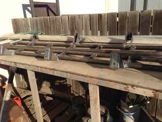

So finally got around to finding a shop to bend up the tubing for me for my sliders, he is thinking that they will be done by the weekend if the material makes it here in time, if not then Monday Tuesday of next week for sure!
Then I am going to weld it all up paint it and bolt it on!
Can't wait to have this protection on! It should have been one of the first things I did, but I had a few other things to take care of before I got to this.
I'll post pics when they are being put together and of the finished product

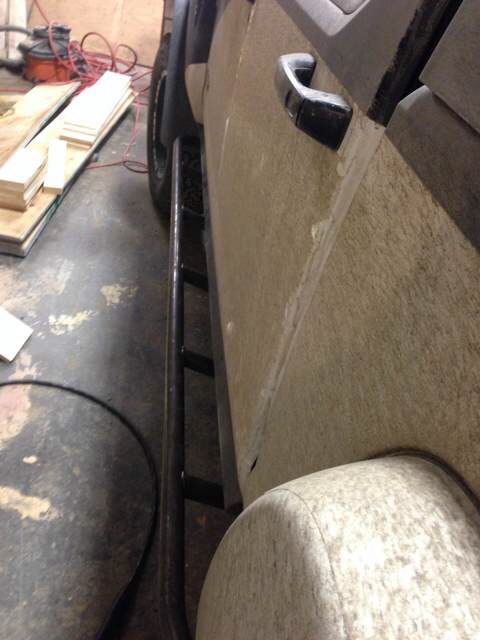

Sliders are now connected to my Mayhem Metal works brackets!!!
Whoo! So stoked to get some paint on these bad boys and bolt them on for the last time!!
Here are some pics of them mounted up pre-paint:
