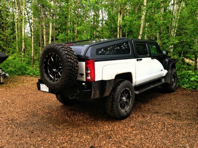

Didn't take any photo's last night, too dark by the time I was done, but got the rear swing out mocked up and everything to work with each other. The swing out arm is longer then I wanted it to be, but I would have to make some major changes to other parts in order to make it all work the way initially I wanted it to, so that as a compromise was what I was willing to work with.
I prob wont have the the swing out finished with the final welds until late next week as I got a busy few days ahead of me this weekend.
Just for a bit of research I drove around today without anything extra in the box of the T, (took out tool bag, hi-lift, full sized spare, emergency supplies, etc.) noticed a huge difference in the ride quality and have some to the conclusion that I will need to upgrade my leaf pack to handle the "new" weight leveraging that far back on the rear of the T.... got to do some research to do, but unfortunately my #1 preferred option (SAO) is likely not going to happen as I wont be able fit into my parking stall at work (6'5'' max).
But I am going to add another main spring to see how that handles the extra weight and then see how that works.
For the summer months I am also thinking that I'll take off and store the Snug Top as well (in the winter it's great for keeping things dry) and hat is approx 200lbs!
