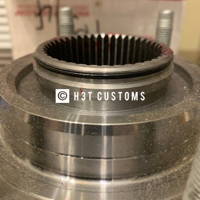

#2 Custom manual locking hubs. I’ve read a lot of forums and tech GM,Jeep manuals. I’ve also took everyone’s opinions on this topic into consideration. One argument which is common,”it won’t work without locking/free spinning hubs.” So, I have found someone who made me a custom pair of front IFS manual locking hubs and CV shafts. As stated above, information/pictures/specs forthcoming.

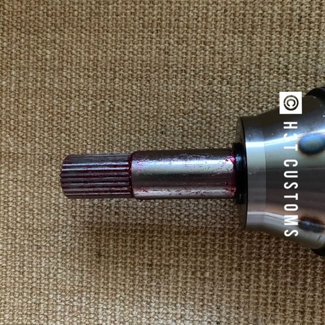

Hubs and Axles have failed! DO NOT BUY THEM; Axle broke inside the locker which required disassembly of the CV to remove the hub/fused axle shaft.

Im guessing the guy that did this is the one that builds the hub kits for silverados as well. I have concerns about the dramatic decrease in shaft size where it goes through the wheel bearing with his design as is necessary to facilitate the locking mechanism. If you are not offroading your truck then it isnt a problem but for us its definitely an issue. I have a 2wd H3 running the np241 and I hate how it handles compared to our other ones with awd but to each his own.
http://therammaninc.com/products/sh...1500-Truck-4X4-Locking-Hub-Conversion-Kit-301
I wonder how those unit bearings will hold up over time with nothing holding them together aside from the turn over of the inner shaft. Seems there is a reason the torque spec for the axle nuts is 190 ft lbs.
$1700, ouch. Those stub shafts look to be slimmed down as well from stock by a fair bit. Hope they were heat treated properly afterwards.

As for the concerns about shaft diameter (and heat treating since I have a feeling he's not making sure the heat treating of axle stub after cutting the splines is still intact), if you're cutting down the diameter of the stub, in addition to cutting splines on it which reduces the effective diameter even further, then you run the risk of creating a weak point in the driveline that wasn't there before. And when you go offroad and hit any kind of obstacle, whether that is mud, rocks, gravel, a steep hill, etc, you're going to increase the chance of simply snapping the axle at the stub. In addition, while it's hard to be certain with the single greay picture of the machined stub, it looks like he machined sharp edges at the transition between the stub, whatever that step is, and the CV body. This is not a good thing to do as it introduces stress risers. Ideally those transitions should be machined with a particular radius chamfer to prevent stress risers that create a potential failure point.
You keep asking everyone else to provide you with the measurements of the Dana 35 et al stub shafts. I went ahead and Googled that for you since I think your goal is to try to get us to prove to ourselves that we're wrong about these concerns. I found this: https://www.therangerstation.com/tech_library/dana_28_35.shtml
So the Dana 28 has an outer shaft diameter of just under an inch. The Dana 35 has an outer shaft diameter of just over an inch with the splines having a diameter of 1.16". Conversely the stock H3 axles have an outer stub shaft spline diameter of +1.4", and the inner stub shaft spline diameter is +1.2". Not even going to bother looking up the Dana 44 or Dana 60 because that stub end you have pictured is clearly much smaller than either of those.
What exactly is the diameter of the splines and shaft on your axles you have there? Looks like it's probably going to be using the Dana 28 hubs? Possibly the Dana 35 hubs? I sure hope it's not the Dana 28 hubs. Those were used on much, much lighter vehicles than the H3 and with smaller diameter tires. The Dana 35's are used on Jeeps with OK results, until you get to bigger tires (35" and bigger). Keep in mind though that the Jeep Wrangler/Cherokee and Ford Ranger/Explorer that use(d) those axles weigh a good deal less than an H3, on the order of several hundred to over a thousand pounds less.
