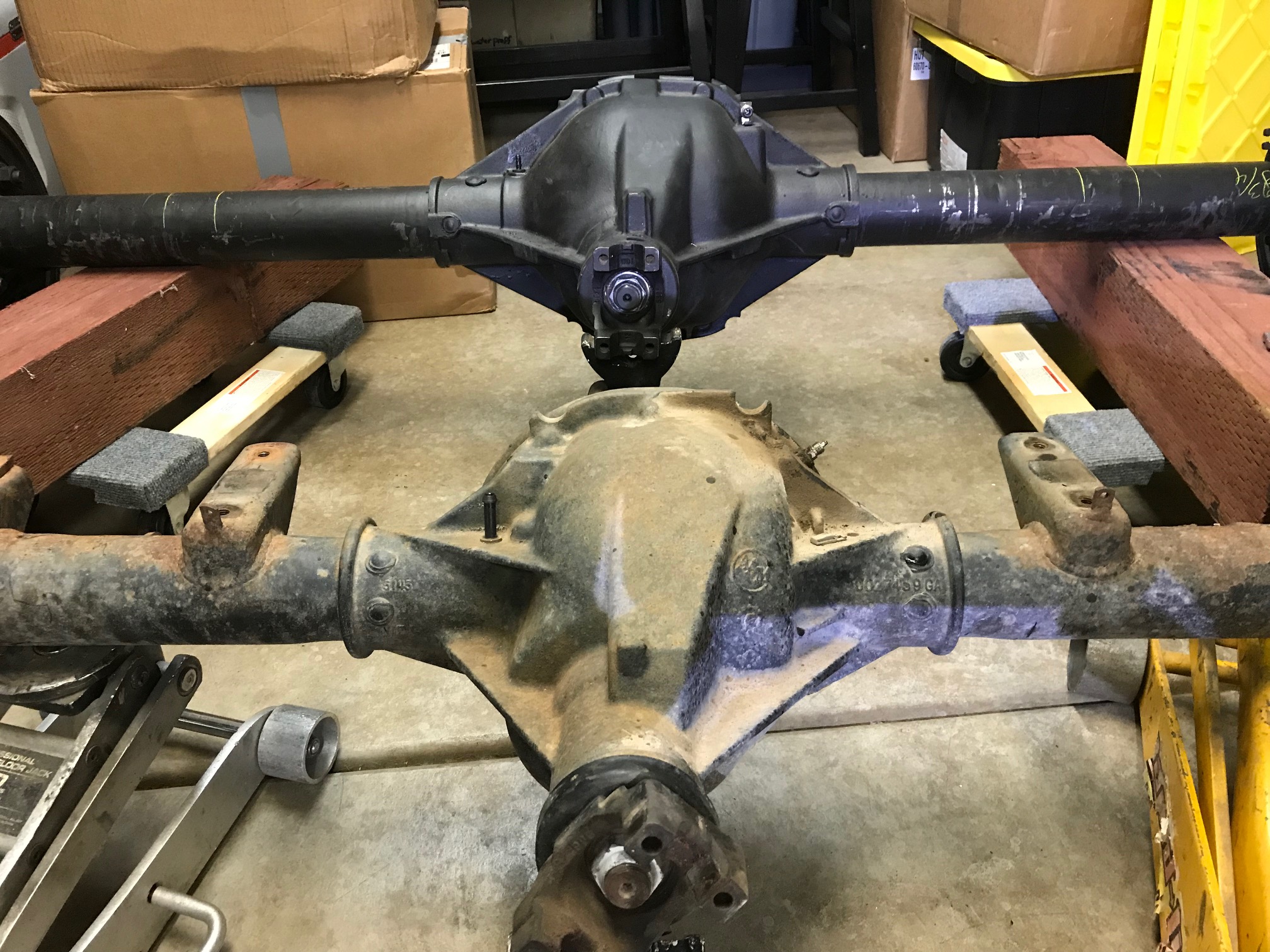

BDDF7029-425B-46EB-8F15-8FE066E67FC2.jpegView attachment 24629New addition to Bebe’s H3b
40” coopers
Before Moab it Will have a 6 lug 14 bolt H2 rear end

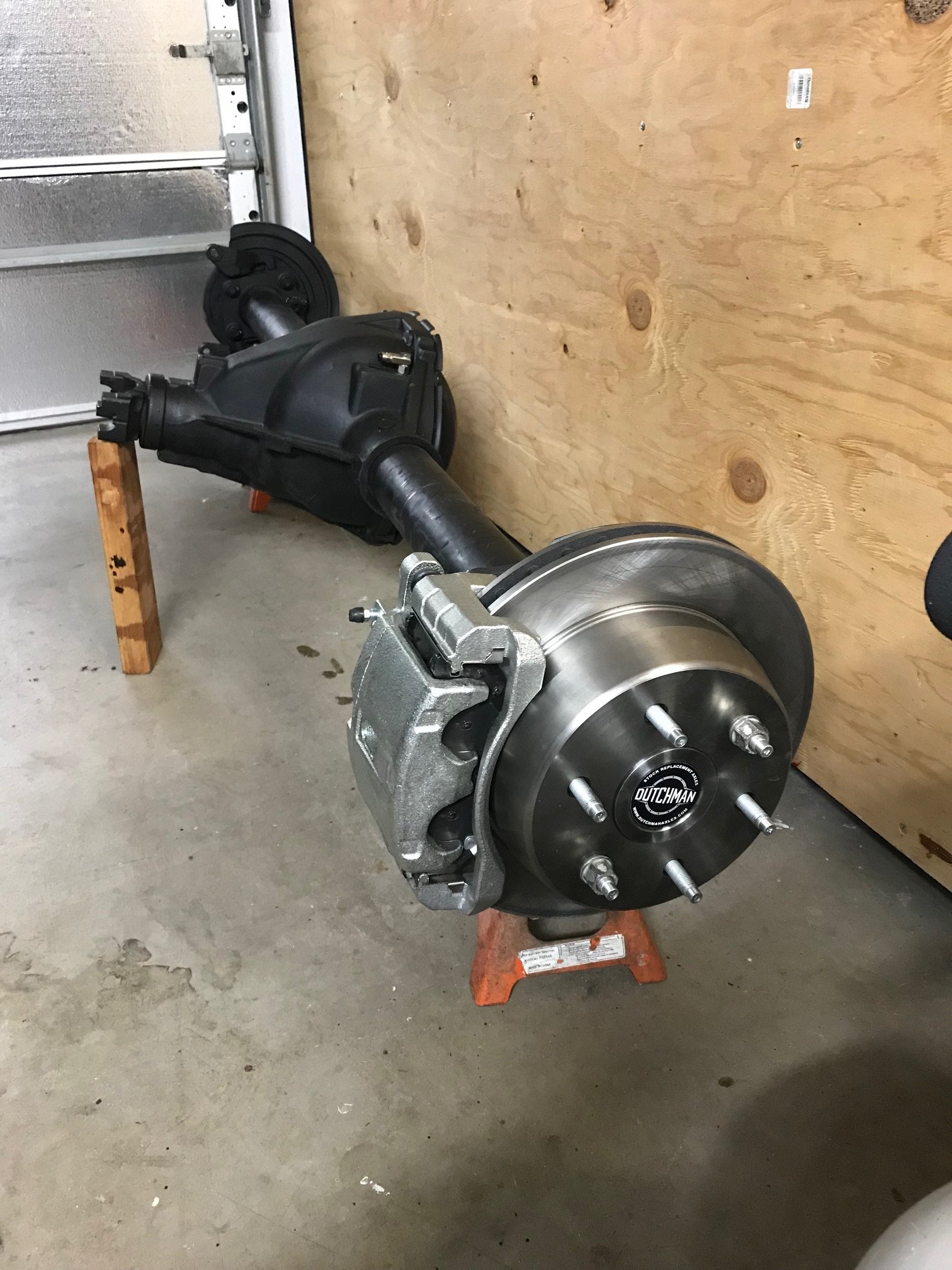

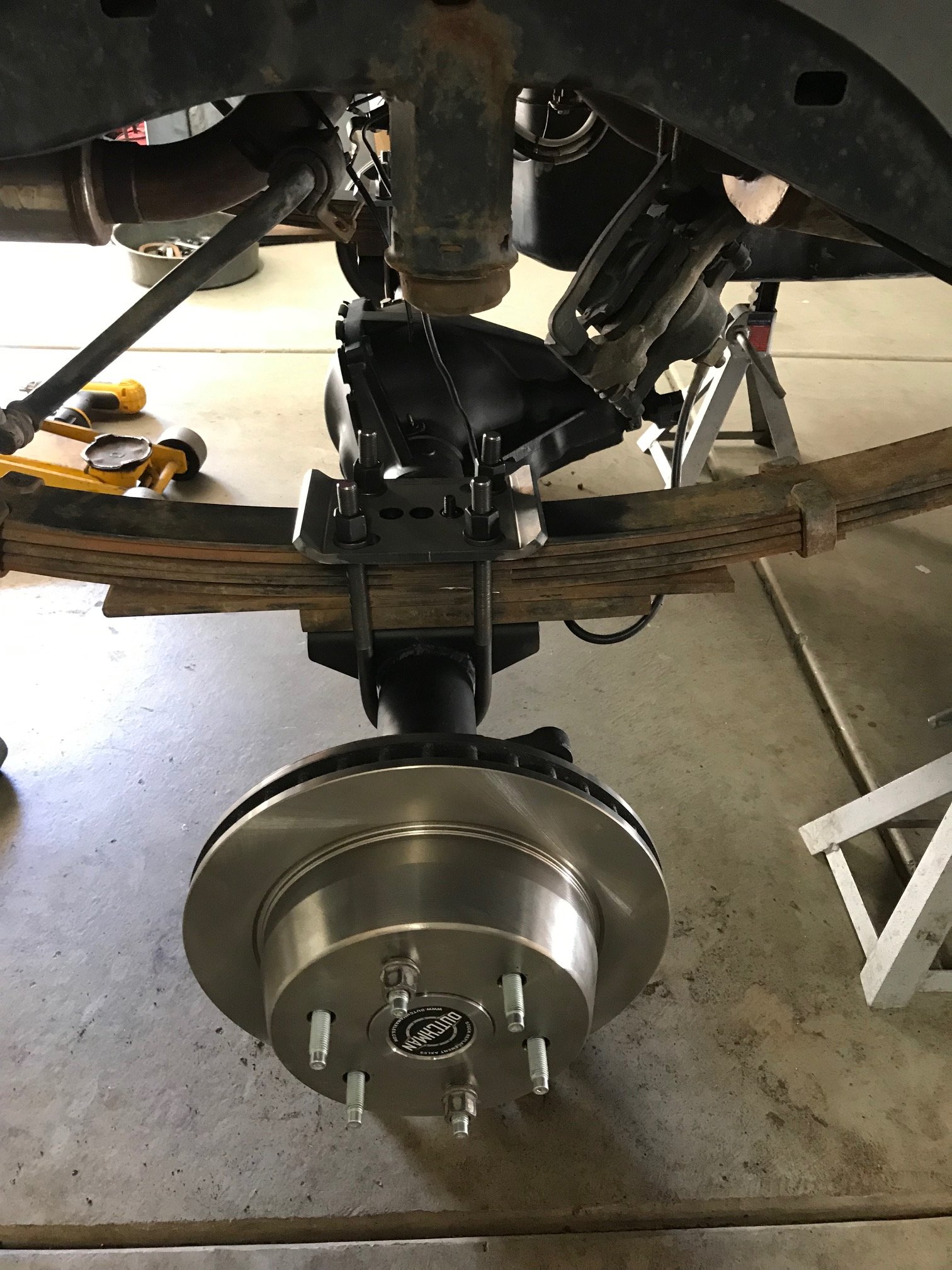

After a couple of delays and not being ready for Moab the project was put on the back burner:sigh:
Until now.:giggle:I'll be doing the install next weekend

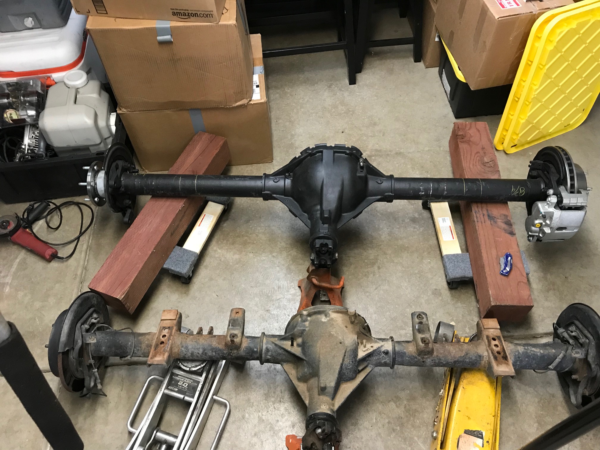

6 Lug semi float 14 bolt H2 axle that will be in Bebe's H3

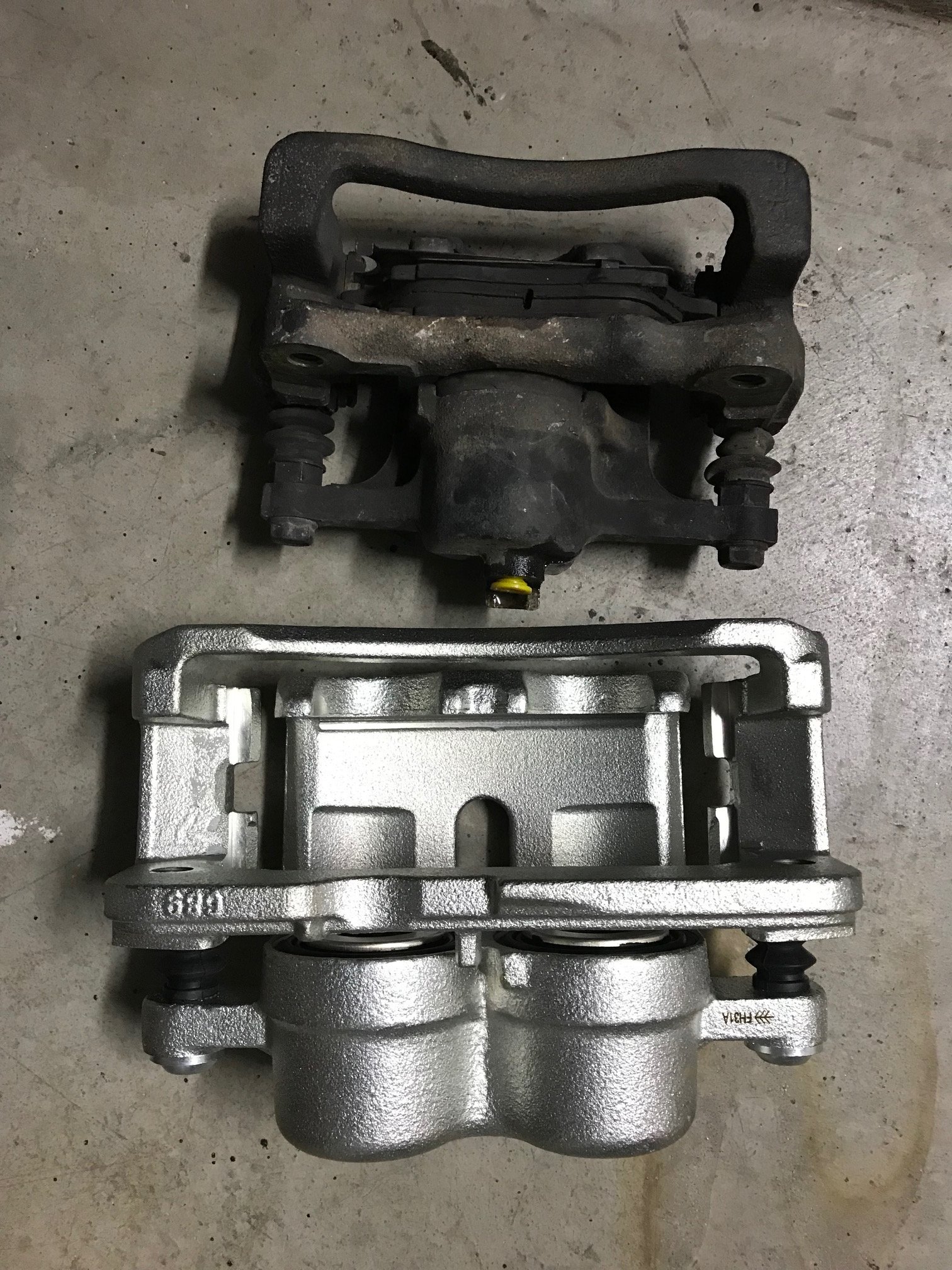

13" vented discs with dual piston calipers. 488 gears with an ARB locker.
So this axle is an AAM-9.25? This has same diff cover as the Burban 2500 axle I got rid of. It’s got 14 bolts on the cover but, the shape is different from the traditional 14 bolt that everyone is familiar with. I always wondered what it was called.
bebe
Moderator
1,375
Dayton, NV
On Pages 44 and 45 of the AAM Catalog (2013) the "AAM 925 14 Bolt w/Electric Locking Differential" is specific to the H2. While the cover might look the same on the "Burb" one you tossed, they are different. The H2 is wider, and at the time had Exciter Rings (tone rings) and came with a locking differential. (2003 - 2009).
Axle shafts are also different and thicker/ taper different (up to the same splines obviously). Surprisingly there was alot of thought that went into the H2 14 bolt semi float

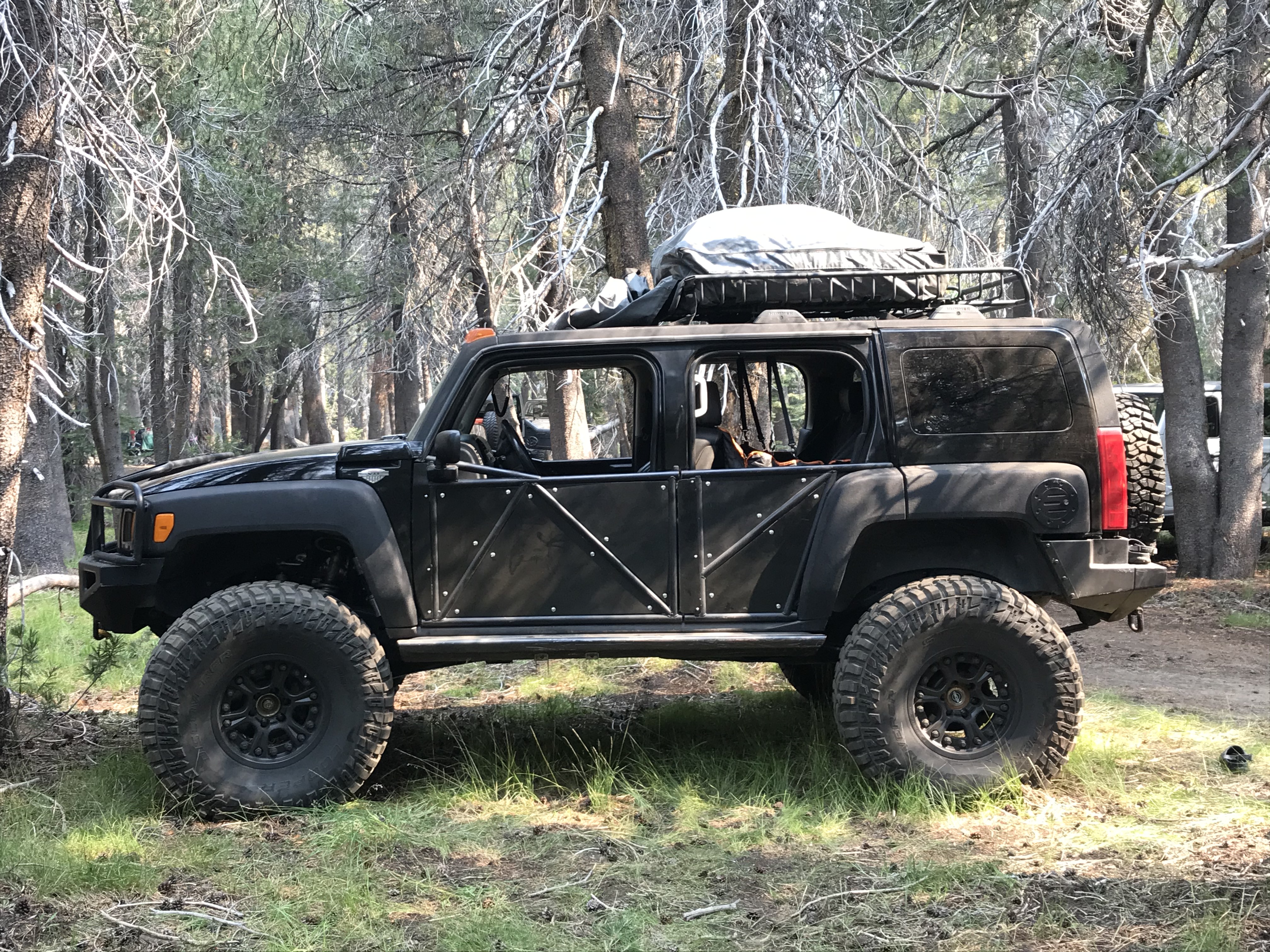

We took the Bebemonster on her first trip rock crawling along with the Pups
My faith has been restored! The Cooper 40's have a much stiffer sidewall providing far less sidewall roll than the 38" BFG's I had on her previously.
Along with the new shoes came some new Hutchinson's. The 14 bolt H2 rear end is wider, just enough to ask the rear suspension to work better, the 6.0 needs zero acceleration to crawl, didn't need to BTM once!
Wow is all I can say. Can't wait for the Forests to open back up so i can take her out again :horns:
