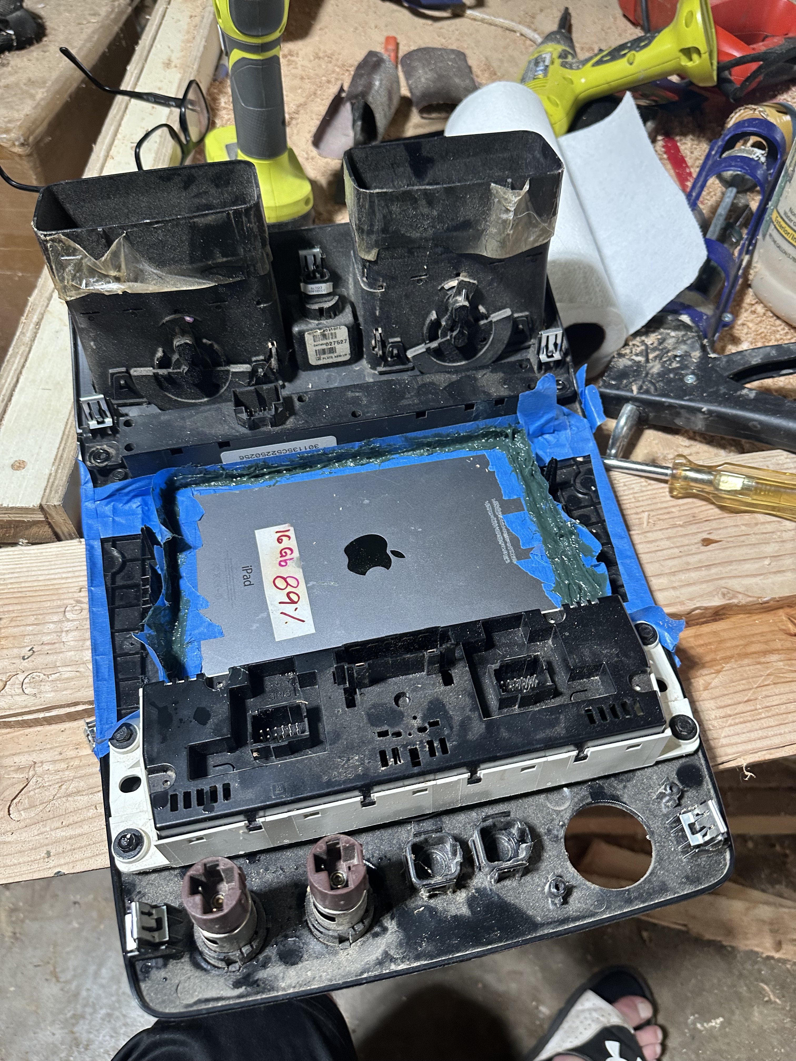

Small update. Tinkered with the radio bezel a bit today. Not extremely happy with how it came out so likely will be revising the bracket into something my ocd can tolerate but it’s in and powers up with a quick test.
iPad is jailbroken so when it sees voltage it wakes up & unlocks, when it sees no voltage it goes into sleep mode
Still need to run some 0 gauge wiring to the amp location and finish up the wiring adapter from the factory amplifier (on order). Carpet and padding should arrive tomorrow and Wednesday so hopefully can get the box and amp rack carpeted later this week.

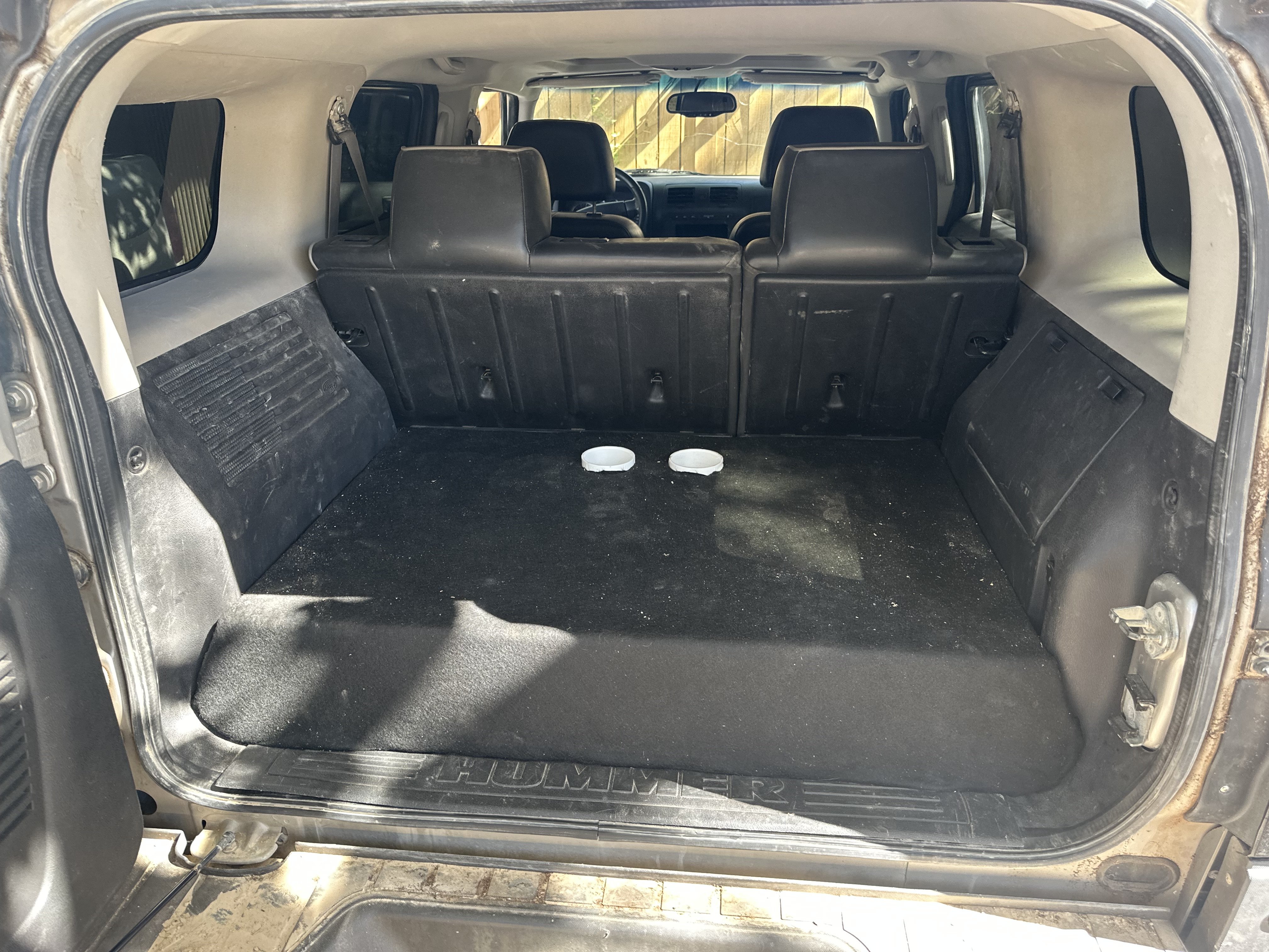

Also got the subwoofer enclosure carpeted & padded but ran out of spray adhesive to finish off the edges. The two ports still need finishing trim installed as well but like I said, ran out of spray adhesive soooo….

Stereo is in and making some good noise. Components speakers installed in all doors and a-pillars. Still need to finish up the port beauty panel but otherwise everything is installed and tuned. All doors and the rear floor have been sound deadened, I will likely pull the seats and carpet out eventually and do the floor and possibly the ceiling.

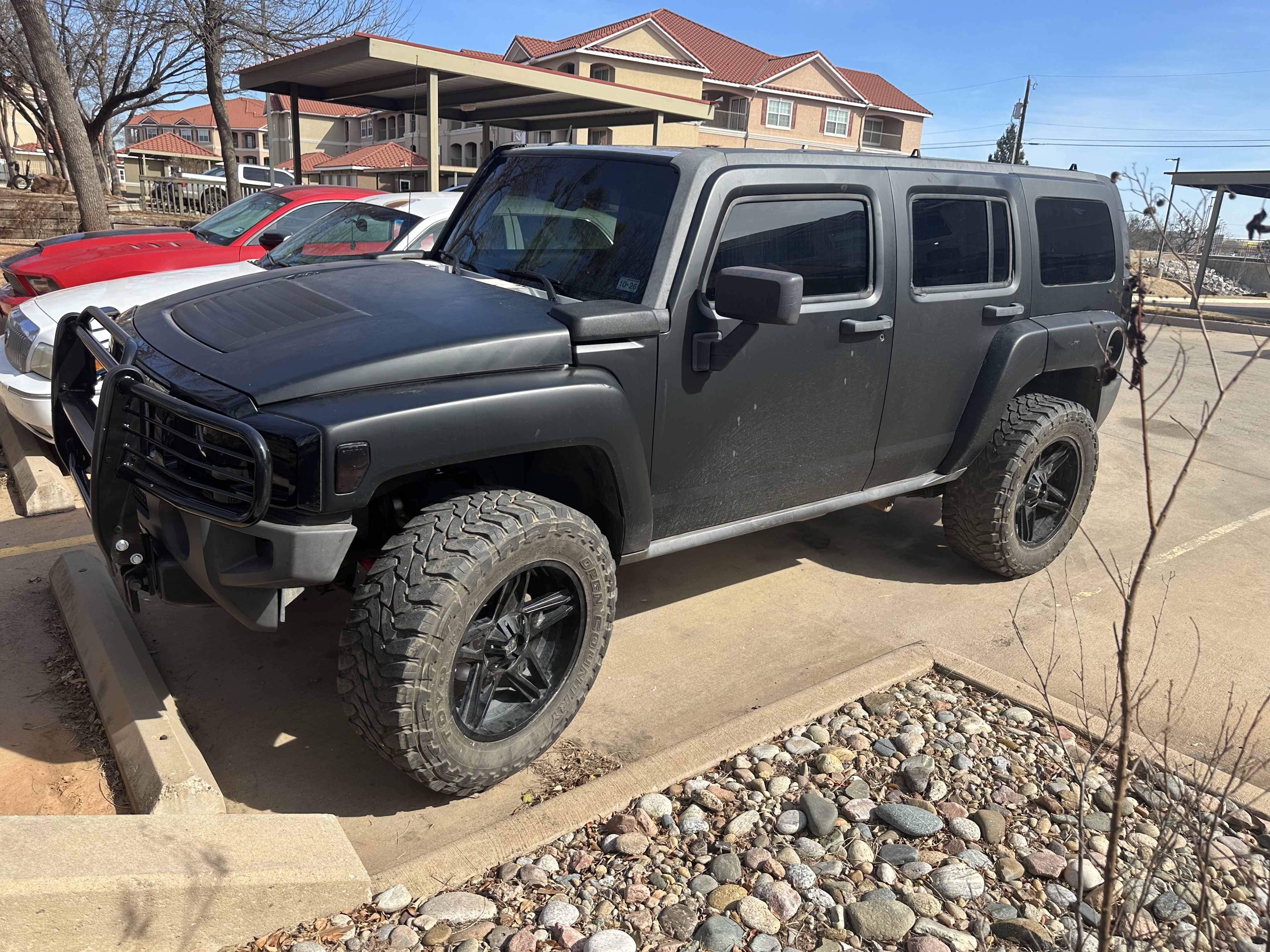

I drove out to Haskel (small town an hour west) to pick up some used 18” wheels on what I thought was a great deal. Looked them over the best I could in the back of the guys truck and pulled the trigger on them. Once I got them home I realized I got scammed….
Wheels were covered in mud when I went to look at them. Once I got them home and cleaned up some I found the wheel stud openings were hollowed out, on every single wheel.
It is what it is, there are always risks when buying on marketplace and this is the first bad experience I’ve had on it.
With every defeat comes great victory though!

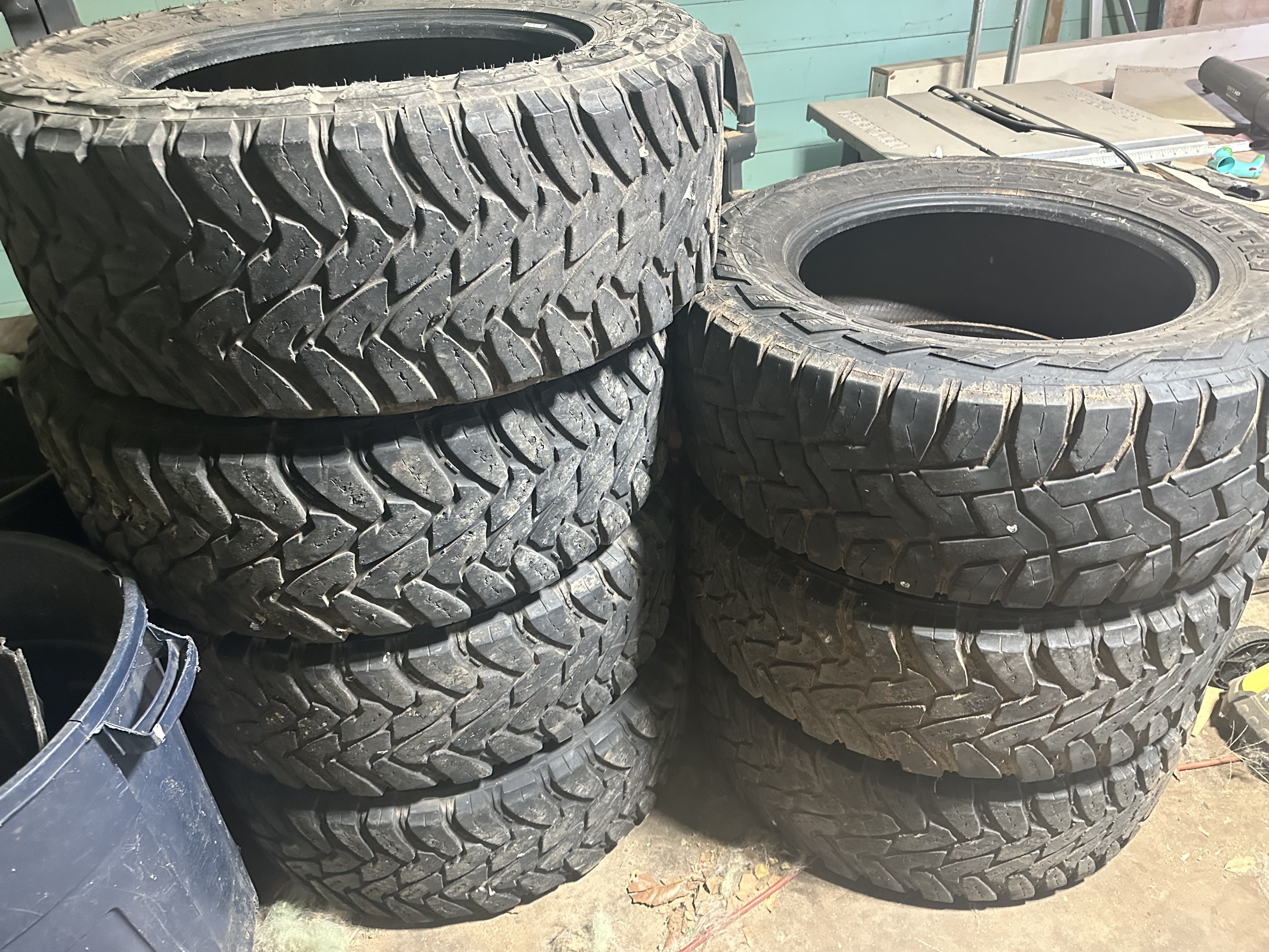

I have been looking for a set of 35” tires off and on for a year or so. They’re not high on the priority list though as my current wheels still hold air and rotate in the right direction however I found a deal I couldn’t pass up.
Got 7 of these Toyo Open Country 315/60R20 for a grand total of $200. Pictures don’t do them justice but they all measure out around 9/32 which is a little under half life on them. They all have the caliche cancer tires get around here but overall they’ll do just fine. I’ll use 5 for the Hummer once I find a set of wheels and sell off the other two and make back some of my money.
That’s all for now. I’ll hopefully get things rolling again once storm season kicks back off

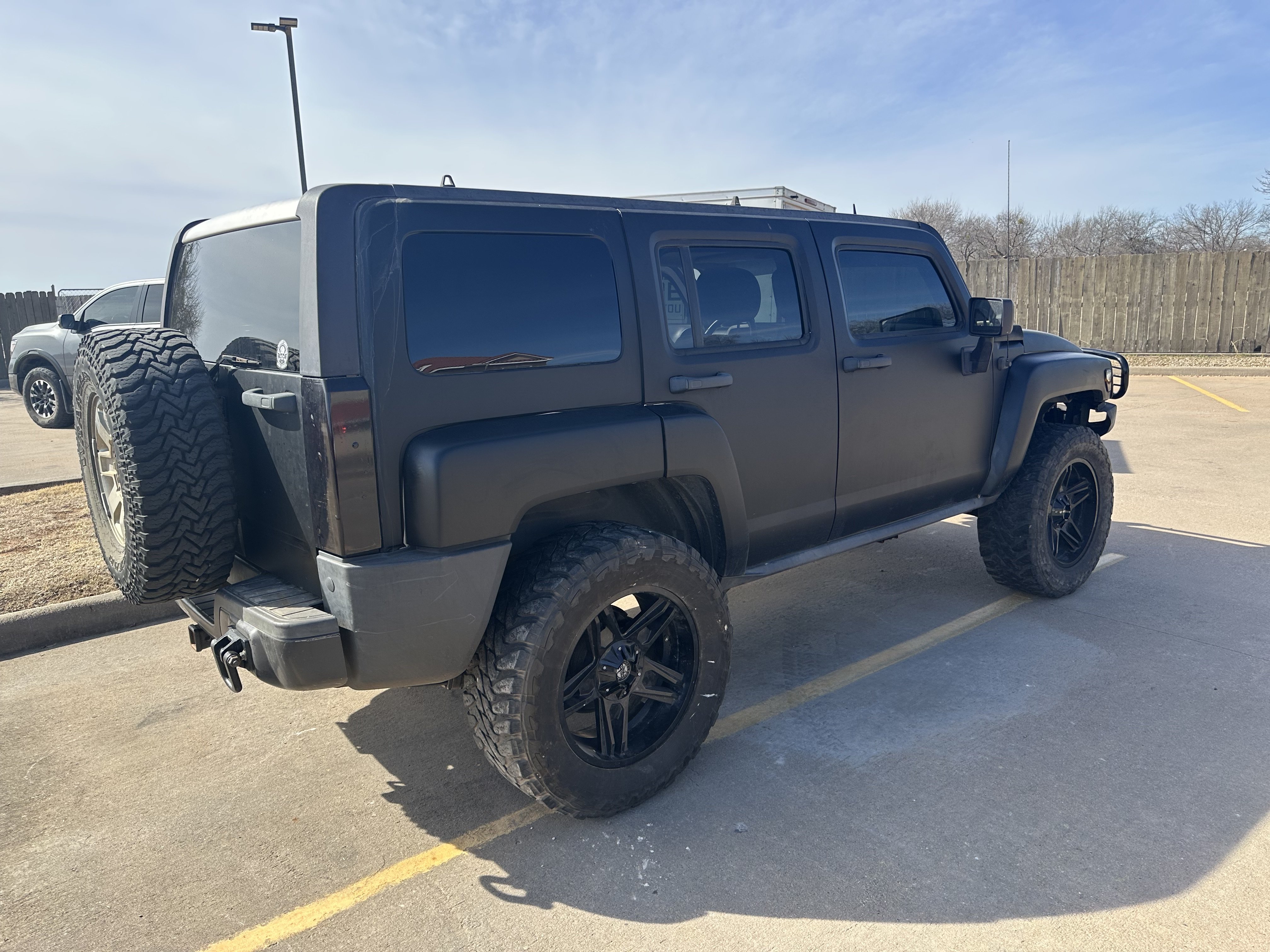

Minor update. Picked up a set of wheels the other day when I was in Dallas for my Pennsylvania licensing test. Wheels are dirty but in decent shape, some scratches and bumps but nothing that can’t be overlooked or repaired easily if I choose to.
Didn’t take any pictures but being the cheap ass I am after many different attempt versions I finally found a version that worked to get off the old worn out tires using the Hummer and a 2x6, instead of paying the local tire shop $20 per tire to dismount the old tires. Basically you just up and run up on top of the bead of the tire repeatedly until it breaks loose.
After a few choice words I was able to get the TPMS sensor swapped over from my factory wheels and one of the replacement tires mounted using some crowbars and some slip solution. Overall I’m happy with the size although I think 18’s would be a better look but when working on a budget we can’t always have exactly what we want. Truck should sit about an inch and a half higher than it does currently with the torsion bar cranked, old wheels measured out to around a 32” if I remember right.

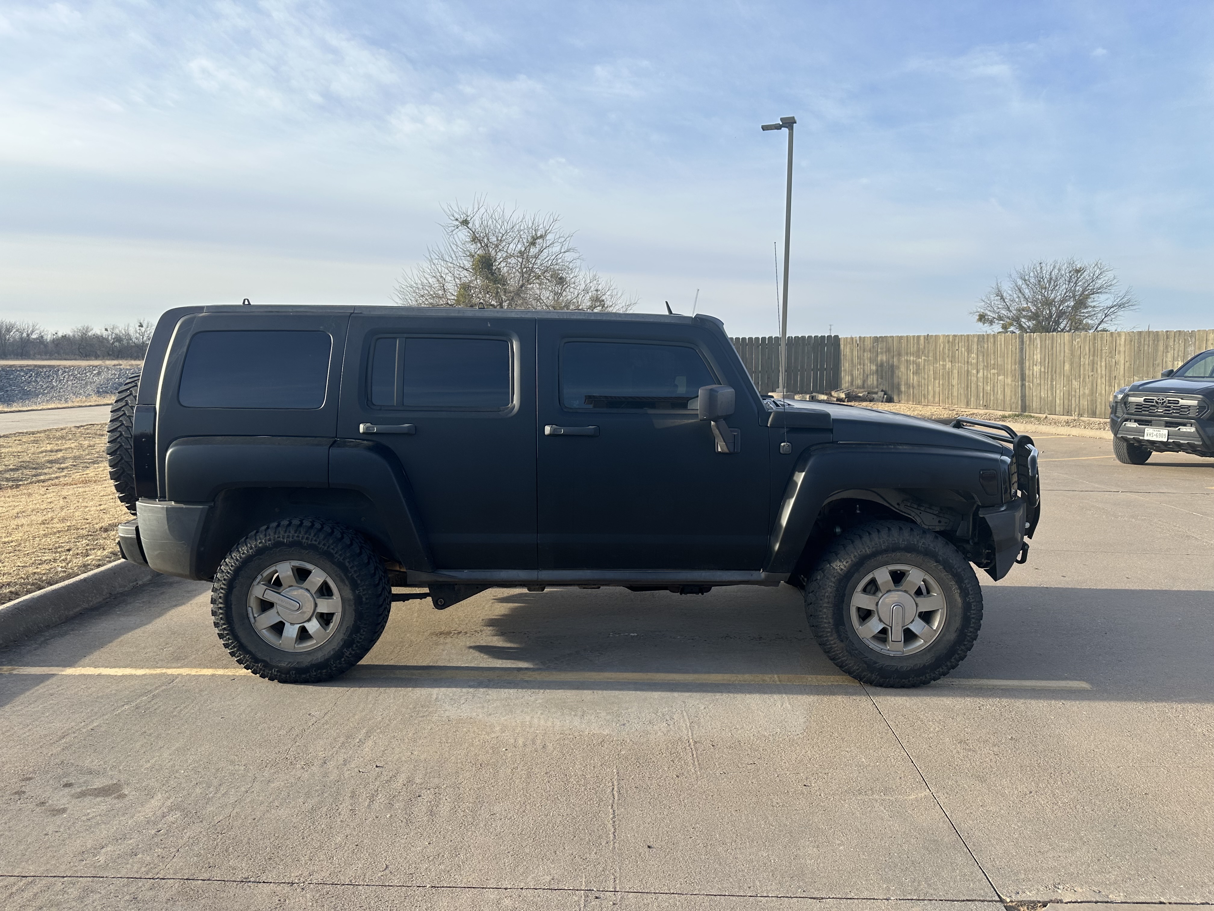

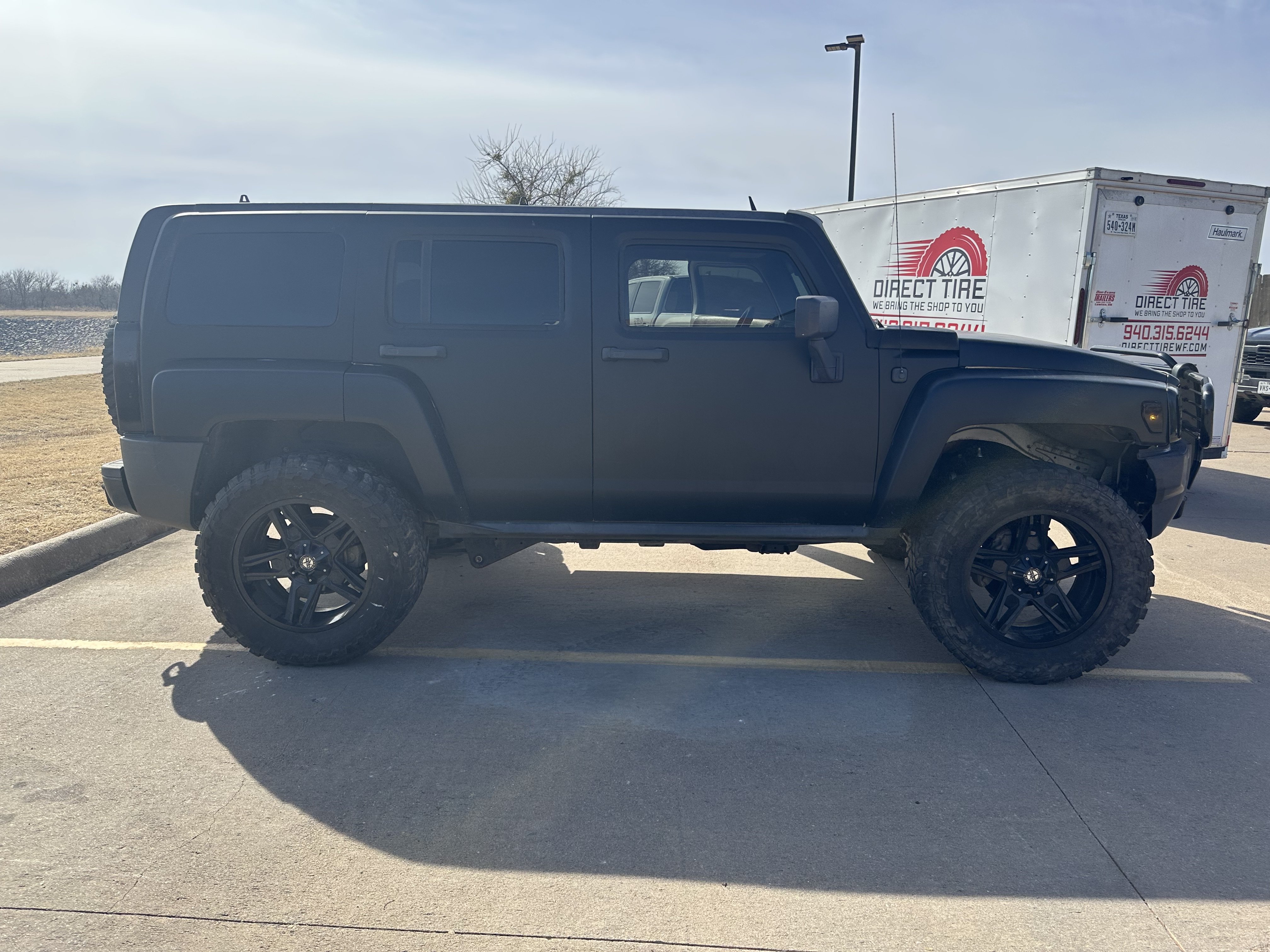

Well finally after some delay I got the wheels and tires put on. Makes a world of difference in appearance with the 35’s filling the wheel well a bit better. Although I still think 18’s would be a better wheel fit I’m happy with the outcome.
Before
After
Changed a bunch of fluids over the weekend, engine oil came out with some clumps but better than the original oil change. However after draining the oil I only got about 3 quarts out of the pan and filter, which means in the roughly 2000 miles I’ve driven since I did the first oil change I lost almost 3 quarts of oil without a drop underneath. Sounds like valve seals are shot or possibly the rings.
Also found a heavy seep coming from the front diff driveshaft seal, just one more thing to add to the list of repairs necessary, but for now I’ll just keep an eye on the fluid levels and continue topping off as necessary. Once the motor comes out this summer I’ll be doing a reseal job on the front diff
