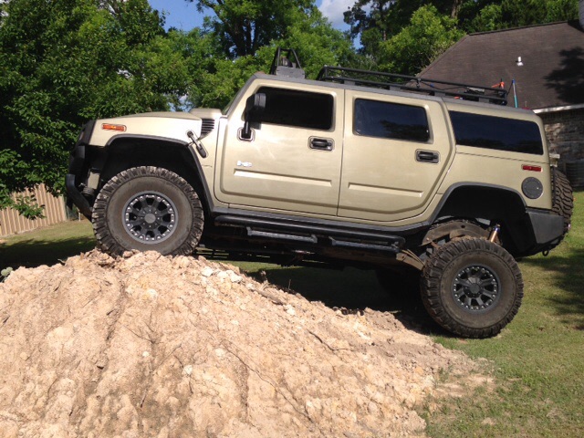

Okay I need some help. Should I go with a 4" or 6" lift. I plan to put 38" tires on her, but don't know whether I should go bigger or not. Sometimes bigger isn't always better.

Sweet lookin rig.

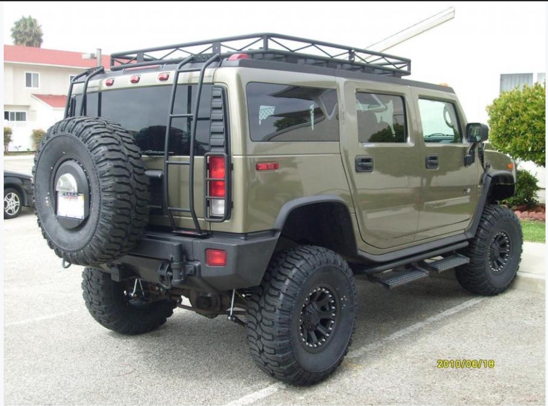

I run a fabtech lift on my rig with 37s and I would like to upgrade to 39s in the future so I am glad I put the lift on my rig.

Quality I think is good.
I have put about 30K miles on the H2 since installed and I have never had a problem with it. It has been wheeled fairly hard and I have bent the front cross member lower a-arm mount on a rock and I have never fixed it and the tire wear still seems to be good logging about 6K miles since incident.
The only thing I have noticed is the finish is flaking off the dirtlogic shocks but that is probably because I never really clean the mud off of them when I finished wheeling.
