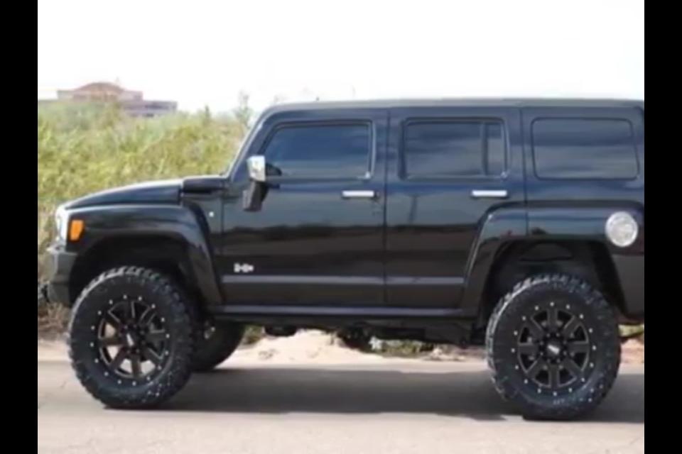

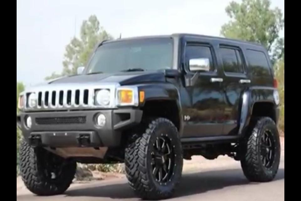

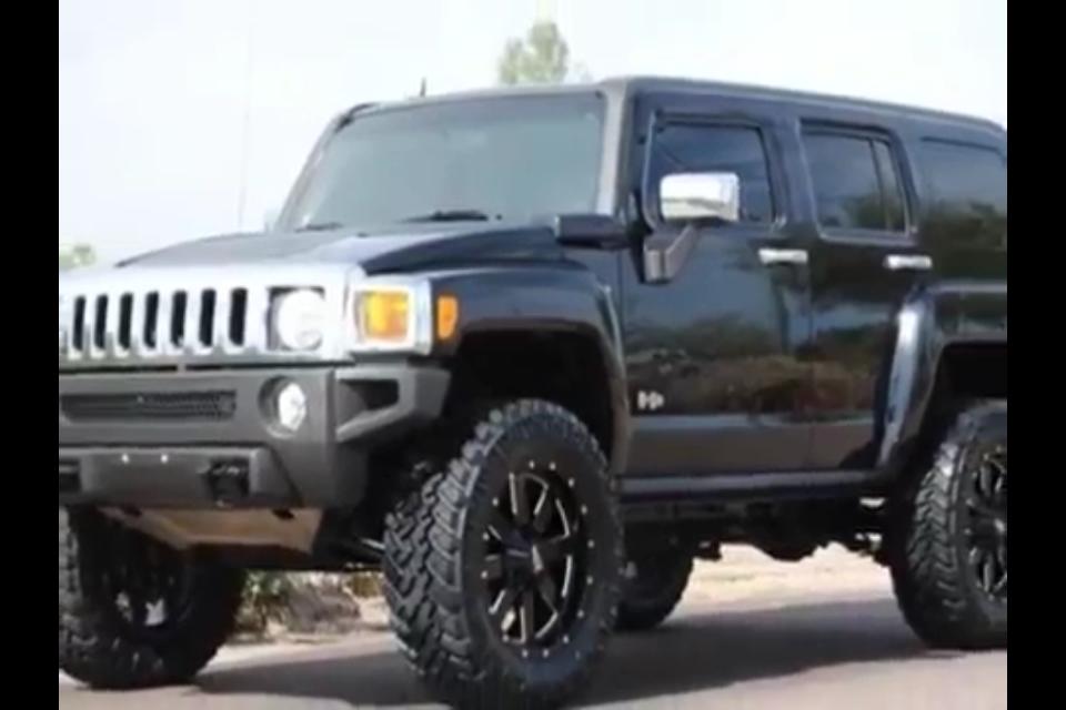

Next month i'll be upgrading my tires to 35" Nitto Trail Grapplers along with Moto Metal 962 wheels. I just cant make up my mind whether to get 18" wheels or 20" wheels. I attached an H3 with 20" Moto Metal 962's and 35's on it. Now the question is 18"s or 20"s?

Do you wheel it? Most people that plan to wheel their trucks won't go over a 17" wheel with 35s. You lose the sidewall flex with the larger rims.

My thinking has always been the less wheel or rim you run the lesser the chance you have of damaging one offroad..Being you're in Florida and not likely to be playing in or even finding a rock garden I'm thinking you would be ok with the larger..
I say go small which is just a personal preference.. :thumbs:

Width is important also........I run 16x8's with my 35s and would not go any bigger than 17s.......... With a smaller wheel you have a bigger sidewall on the 35" tire......... When you air down a bigger sidewall tire you get a much bigger footprint which is great for sand driving. (Florida had plenty of sand when I was there last time!!!)
