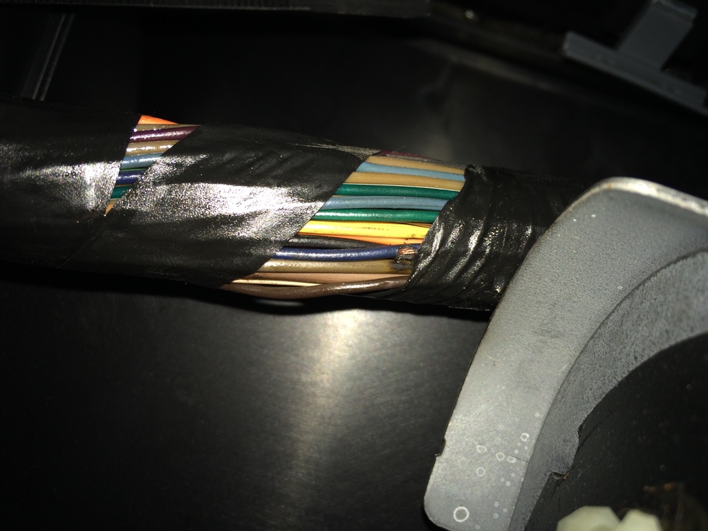

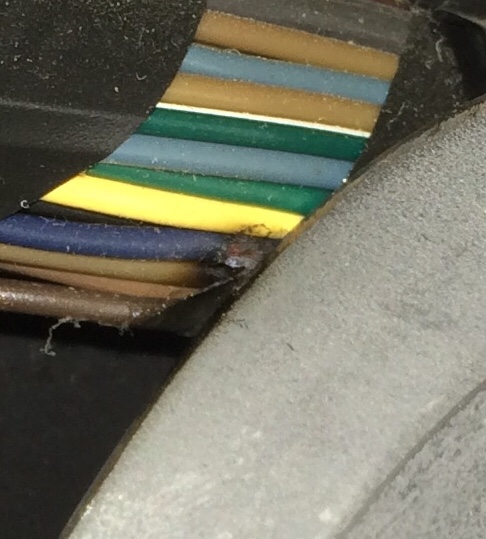

Got it!! The main wire harness running through the top of the dash was rubbing on the metal part of the airbag frame and cut through one of the power wires insulation. It was chafing and arcing and that is what was causing the ignition fuse to pop.

ImageUploadedByTapatalk1413087149.612702.jpgImageUploadedByTapatalk1413087162.774041.jpg

I had the intermittent chime as well but fuse was popping. The loom had come off the plastic clip at the top of the dash. Be aware, if any aftermarket installation of radio or pulling on harness or even some off roading could cause loom to drop down. It will rest on the sharp edge of the air bag housing and as you can see the rest is history.
