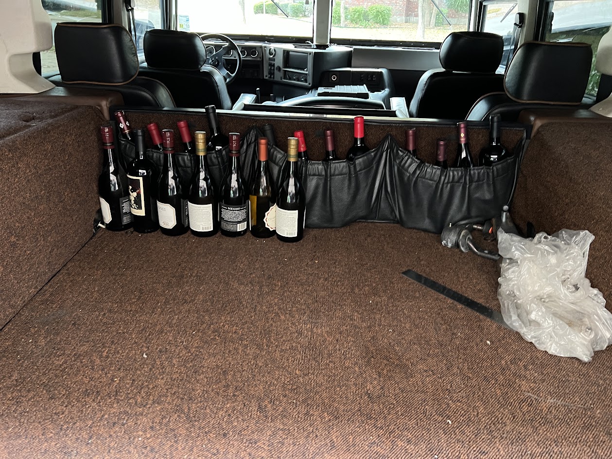

I finally figured out what those pockets behind the divider are for !!!

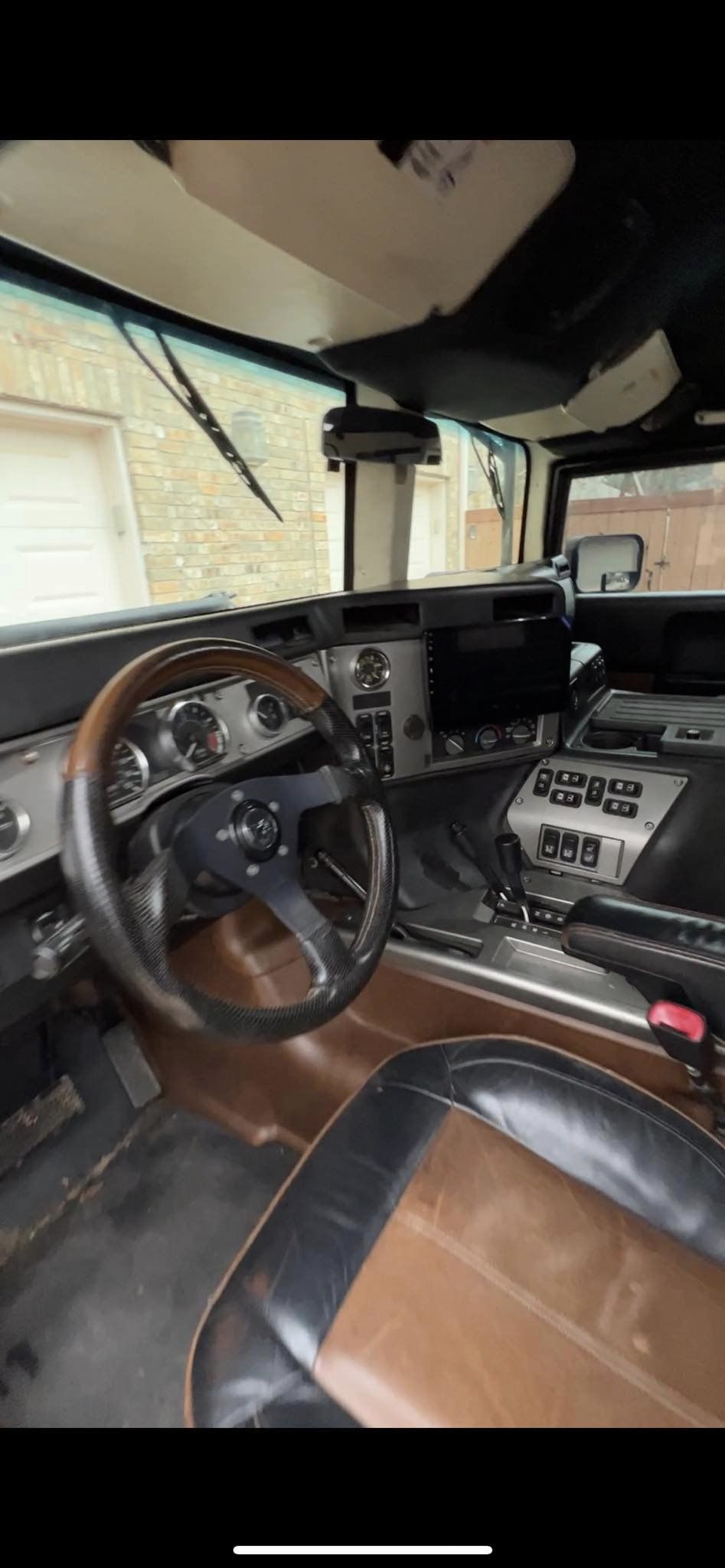

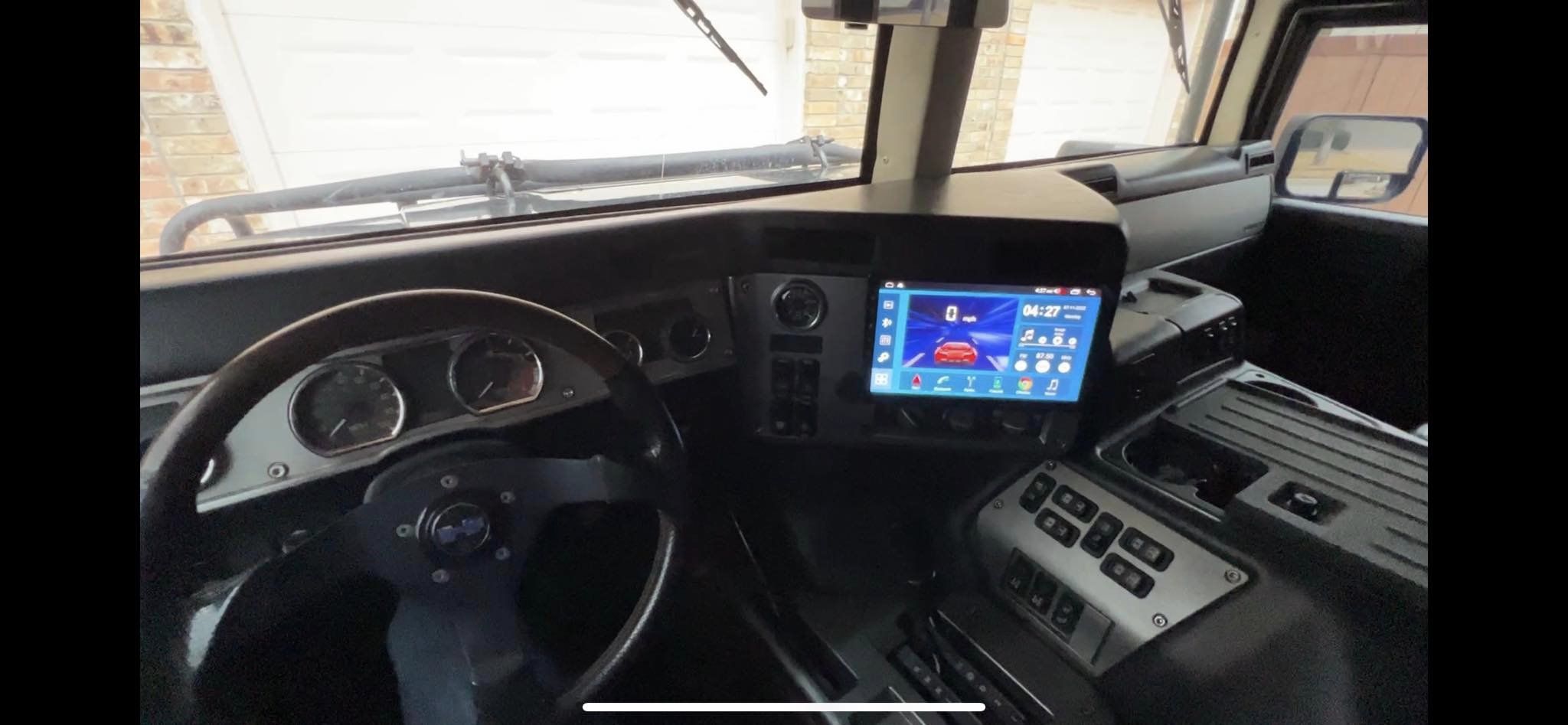

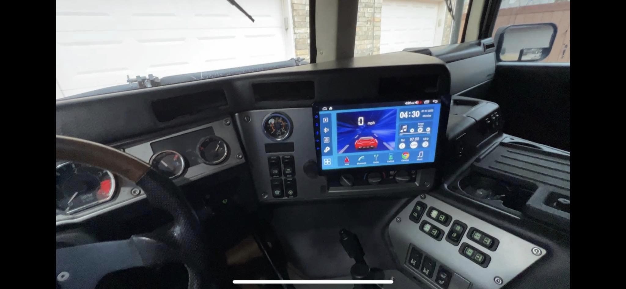

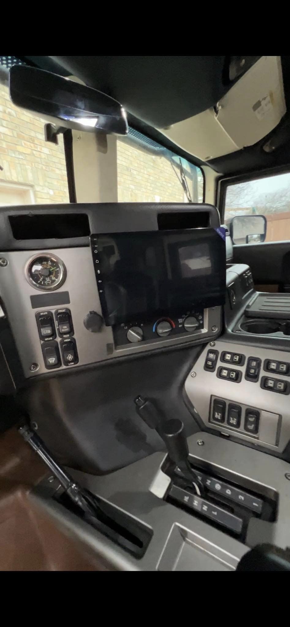

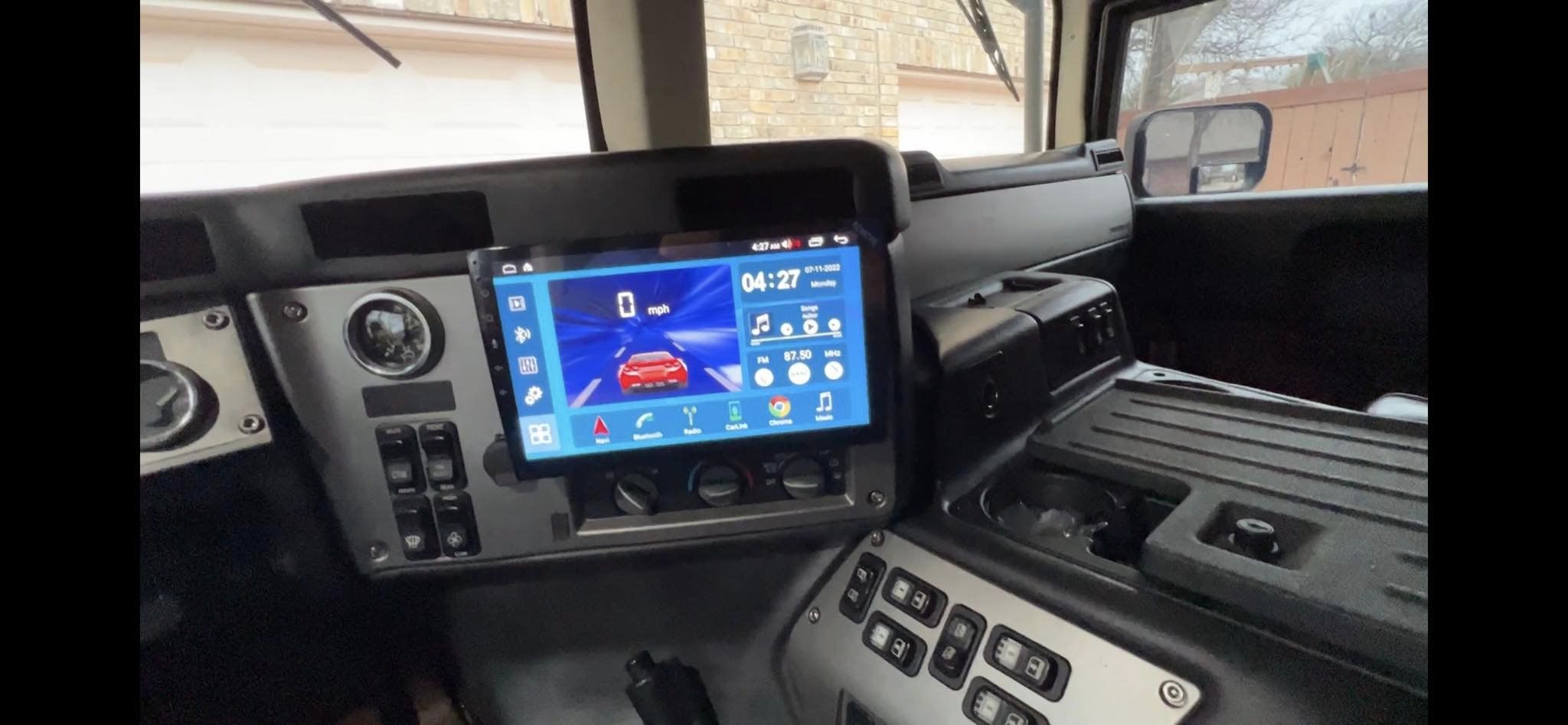

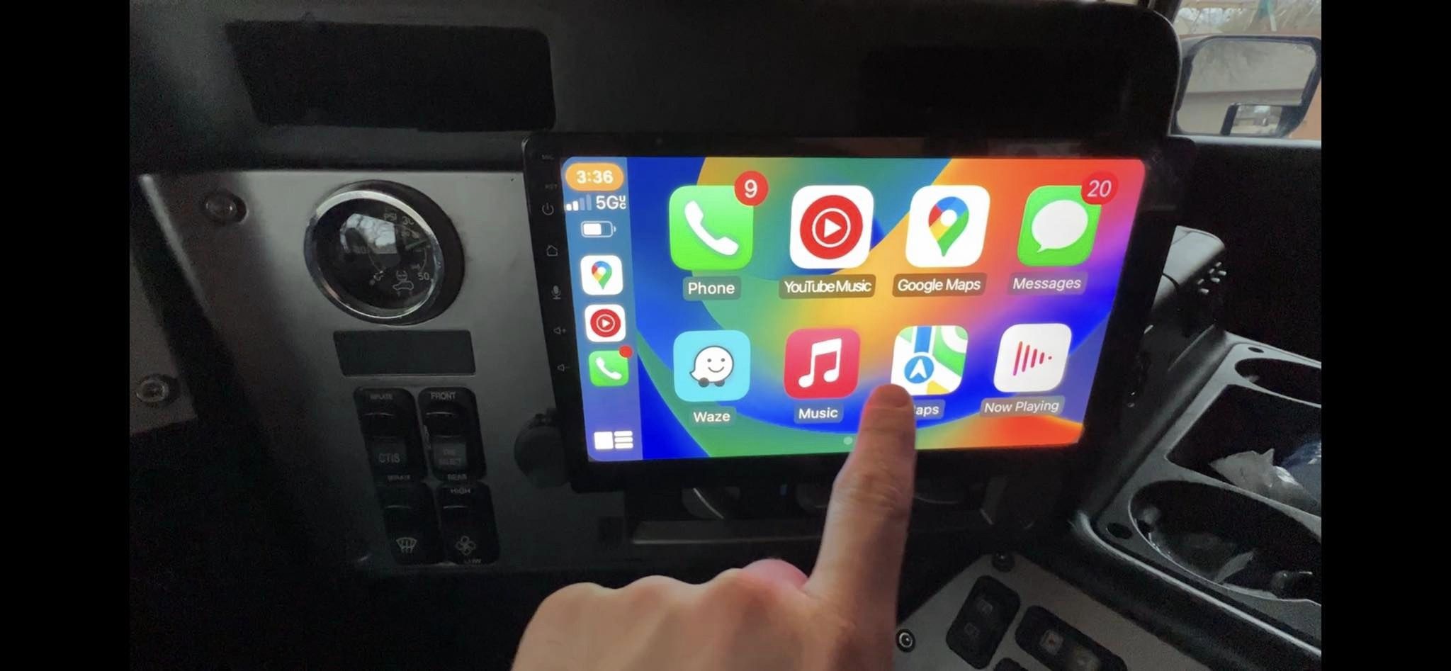

I loved the look of the original factory stereo. But like a lot of you mentioned, I missed my CarPlay and my apps.
This is the unit I bought now. I think this one is perfect for the 2004/2006 Alpha interior.
https://amzn.to/3XOH5Kg
Ditched the 7inch screen and went with this 10inch unit. Has a lot of height and angle adjustability so I could get it positioned exactly where I wanted. Fits perfectly between the AC vent and Climate control without covering either one. The display is surprisingly sharp and plenty bright. And it’s very fast with no lag. And right out of the box it connected easily to both my iPhone and my Google Pixel. Sounds great too. Very happy with this one, and at $200 it’s a steal! I’ll do a full video on the install soon.

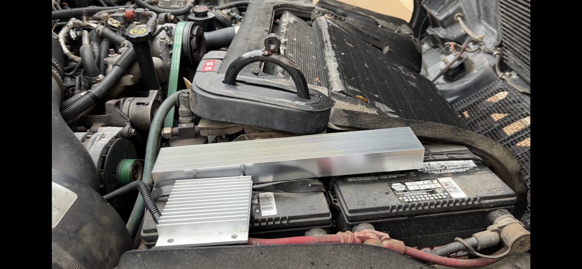

The new extra large heatsink that I'll be replacing the current heatsink with, for size comparison. It's much larger, with a lot more cooling fin surface area
