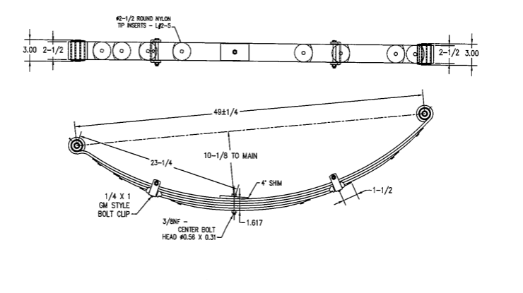

Thanks for the detailed reply!!!! By loose I meant it’s just held I place by the sway bar links. The leaf spring to axle pin was a solid 3” forward of the axle pin hole.
I’ll persuade it into position and see how it looks. Been on the road a bunch so it’ll have to wait another week end or 2. Good news, I did receive the below specs from Rancho. First pulling together the bushing info, now the leaf specs form the depths of obscurity. Thats some customer support for an obscure and discontinued product!!!
Thanks again!!!

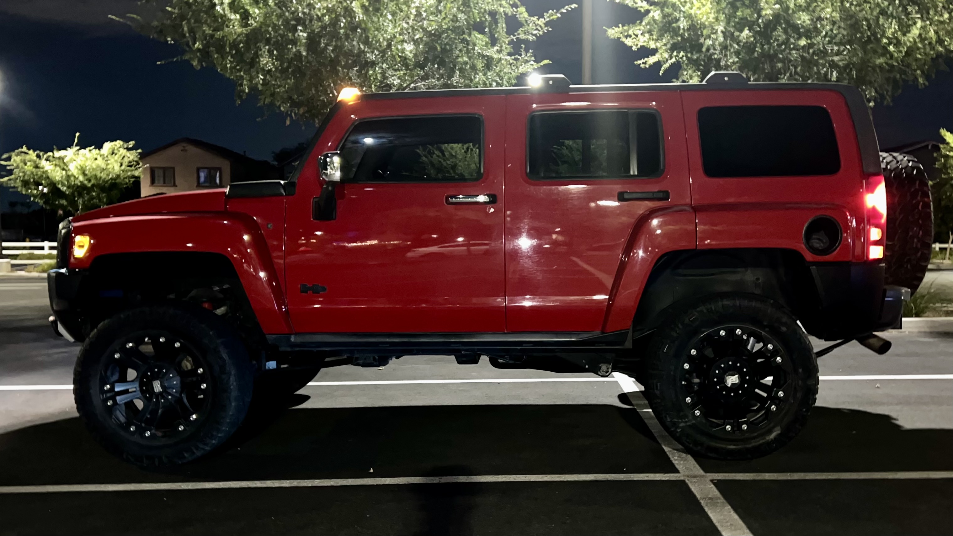

Finally got it right!!! Stance is right on the money!!! No more banging at the slightest dip in the road and drives much better. So nice!!! Spring shop warrantied the whole thing and re-arched them to Rancho’s specs at no charge!
The above Rancho specs are on the money. I measured and confirmed these leaf springs are exactly on spec per Rancho.
Dunbar Spring in Phoenix is great!
