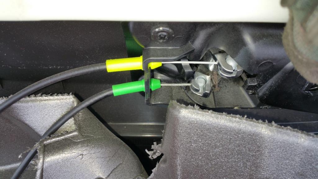

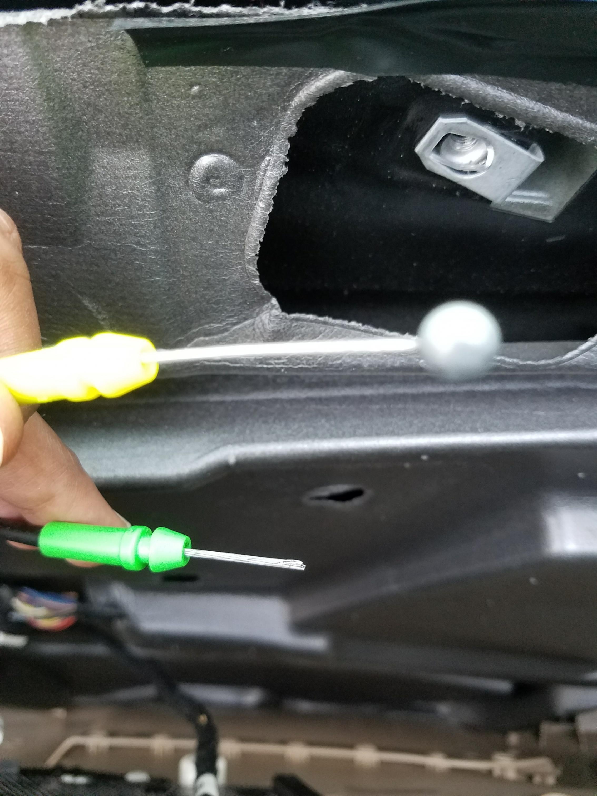

So I was right. I took off the door panel and saw this. That round head broke apart from wire.
I there any place I can get just this wire?
nelly27281
53
Dublin OH
Wow, that's pretty surprising that broke. Did the wire itself break or did the ball pull off of the wire?
I am very much surprised too. I don't have any clue how its broke, just remember, other day tried to open the door and it didn't open. Looks like wire and ball join was not strong enough.
